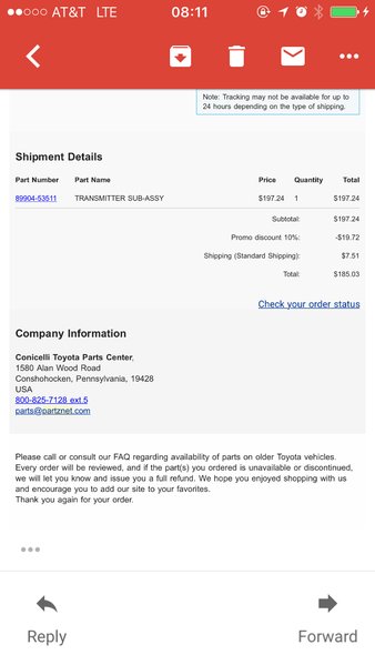

    Haha. I have it in my cart with that same code applied.
    It has to be the correct one. It's the same pn as the op posted. Searching that key on eBay there are a few different pn's too.
    Maybe it's called a sub assembly because it doesn't have the key too. So not complete.
  18. Jan 17, 2017 at 5:12 AM
    #138
    Victory
    Victory [OP] Well-Known Member
    Mar 13, 2016
    #181167
    1,048
    St. Pete, FL
    2016 White Tacoma TRD Off Road
    It is called a sub assembly apparently. Here is a screen shot of the order confirmation from when I ordered I just found in my email for you.
