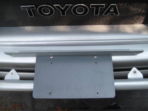

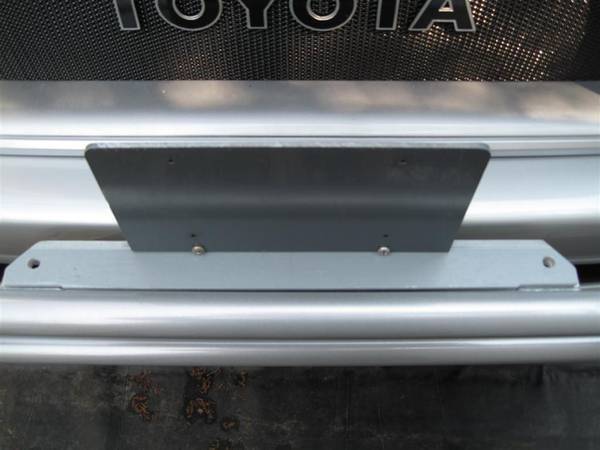

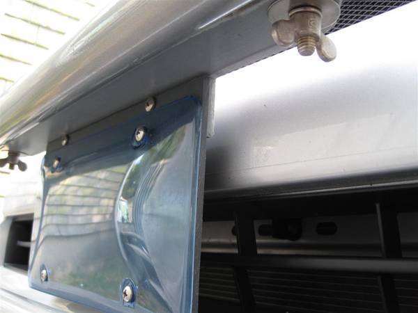

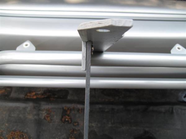

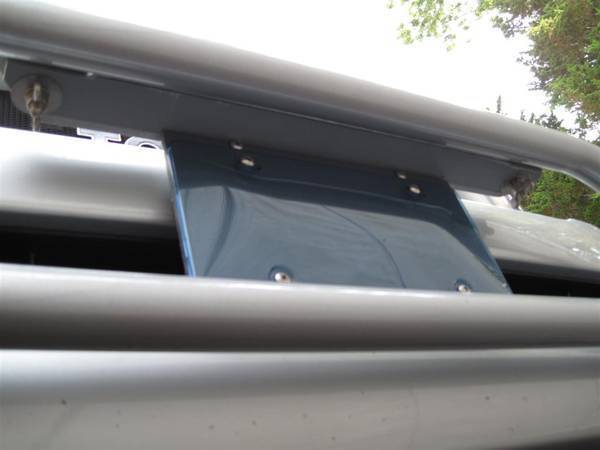

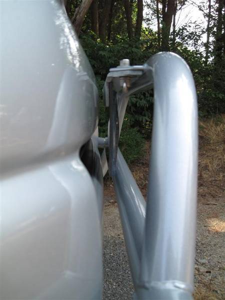

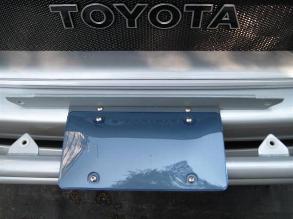

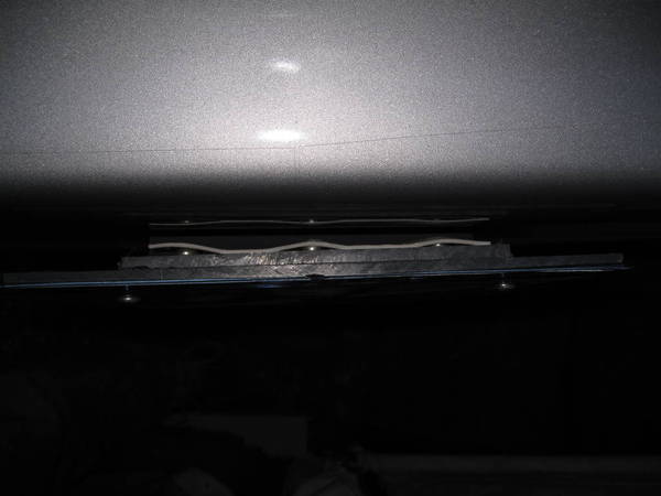

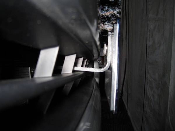

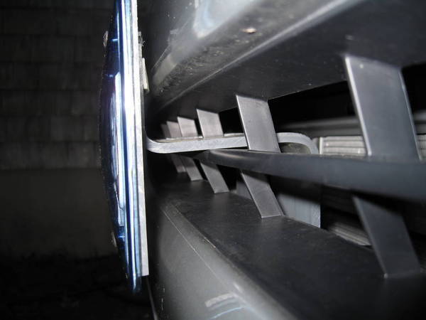

    In Post #7 Above is the temporary bracket I made to keep the "Dealer Holes" out of my bumper.
    Pics Below of the Bracket I made for the AVID Light Bar I installed.
    Intend to do a write-up when time permits
    Used 2" Angle Fiberglass and 1/4" PVC Drilled & Tapped for 1/4-20 Stainless Screws
    3/8" Stainless Bolts - Bracket to Bar
    Thumb Screws and Socket Bolts are for Quick removal for pictures and until I color match paint it
    Only Contact is on "Light Tabs"
    The fiberglass is quite strong, so there's little to no movement
    Should be pretty self-explanatory
    Sorry, Pics aren't in any order
    Should be able to see enough detail when blown up
    Sent Pics to Brandon, He Liked it
    STILL NO HOLES in my bumper
    Why would Toyota engineer a $30k truck (or any of their vehicles) so you have to screw the plate to a plastic bumper. WTF
