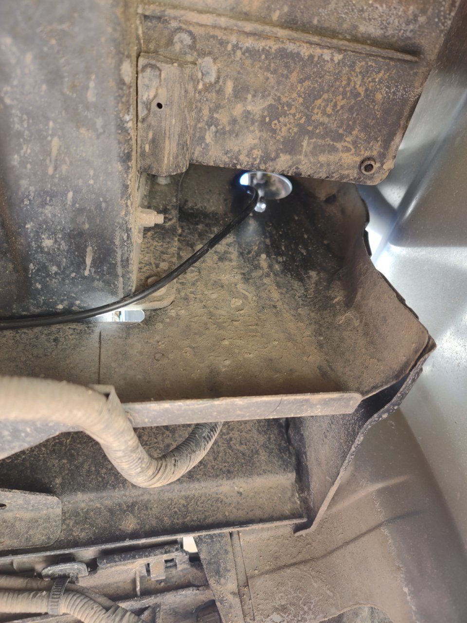

    I ran into a situation with my MEX made 2017 TRDOR DCLB where the stud to mount the relay is about 6" higher than the above picture shows where to mount. That caused the harness to be too short when following the directions; "Feed the longer end of the harness through the hole at the bottom where the factory harness exits the tailgate cavity".
    I ended up feeding that harness through the vertical round hole that is right behind the housing which ended up being working out very well.

    Thank you for this feedback. I’m not sure we ever did a test fit on a DCLB, assuming it would be the same.
    If it’s not too much trouble, would you mind gathering a measurement of how long it should be if you routed it exactly how you’d want it? I can probably swap you out at a later date with a long version. You’d be helping the community as well if others encounter the same.

    If routed your way, 3" would work well.
