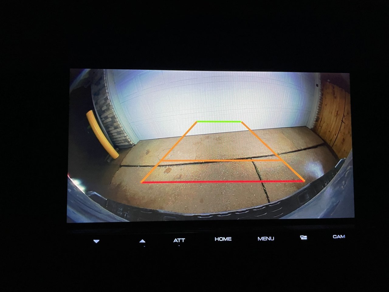

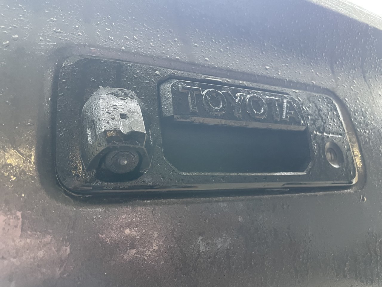

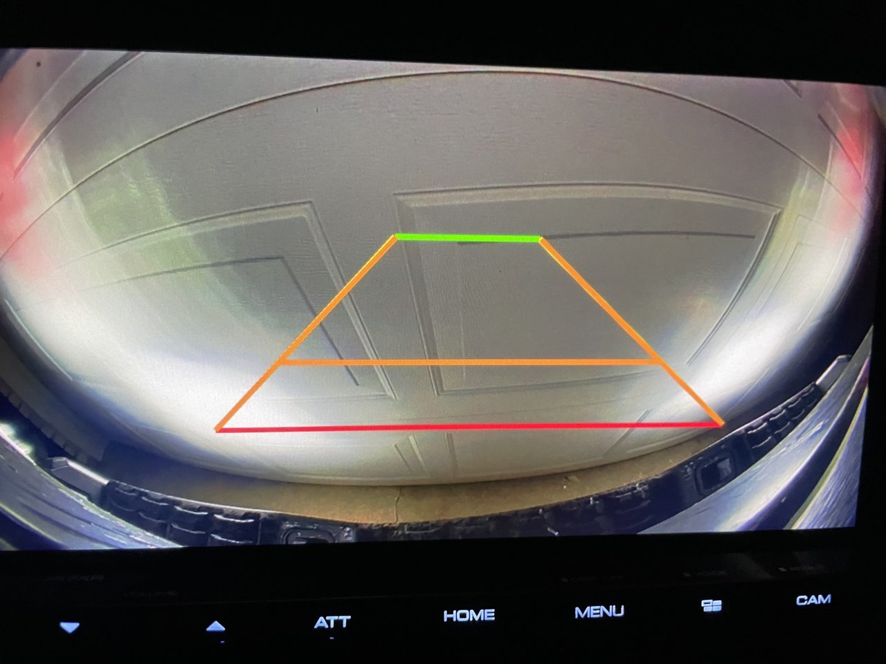

    Couple of Questions:
    1. Do you have the OEM head end screen in your dash or did you upgrade that also? (don't want to improve the camera only to still have a crappy view.)
    2. Is the Kenwood camera plug and play? (Do you just unplug and unscrew the OEM camera and then plug in/screw in the Kenwood one?)
    Thanks in advance
  9. Dec 10, 2022 at 3:07 PM
    #709
    BLtheP
    BLtheP Constantly Tinkering Member
    Apr 5, 2022
    #394355
    4,477
    Plano, TX
    2021 MGM TRD On-Road DCSB MT
    RC60F Transmission ADD delete with FJ full-time tube FJ Metal Clutch Pedal OEM Mexico-Spec Condenser Fan 265/70R16 Michelin Defender LTX M/S 2 OEM 1-Piece Lug Nuts Custom Built Switch Panel for all Electrical Accessories Rigid Amber Pro D-SS Ditch Lights Rigid 30" SAE High Beam Driving Light Bar Rigid SR-Q Pro Back-Up Light Kit (Recessed) VLEDS Tail Conversion VLEDS Foot Well Light Kit KC HiLites Cyclone V2 Under Hood Lights Operable (Switched) Clutch Safety Bypass
    I have a Kenwood DMX957XR in the dash. I’ve had that radio for a few years across various trucks. I was going to sell it when I got the Tacoma, thinking I’d like the factory head unit enough to keep it (since it has factory CarPlay), but alas I thought the stock head unit was terrible so I swapped in the Kenwood.
    The Kenwood camera is not plug and play at all, it has a built in 10 foot cable and then another 15 foot extension harness. The camera cable threads into the extension harness, then the extension harness gets spliced to key-on power and plugs into the yellow video jack on the back of the Kenwood head unit.
    The camera itself needed a bracket fabricated to mount it in place in the tailgate.
