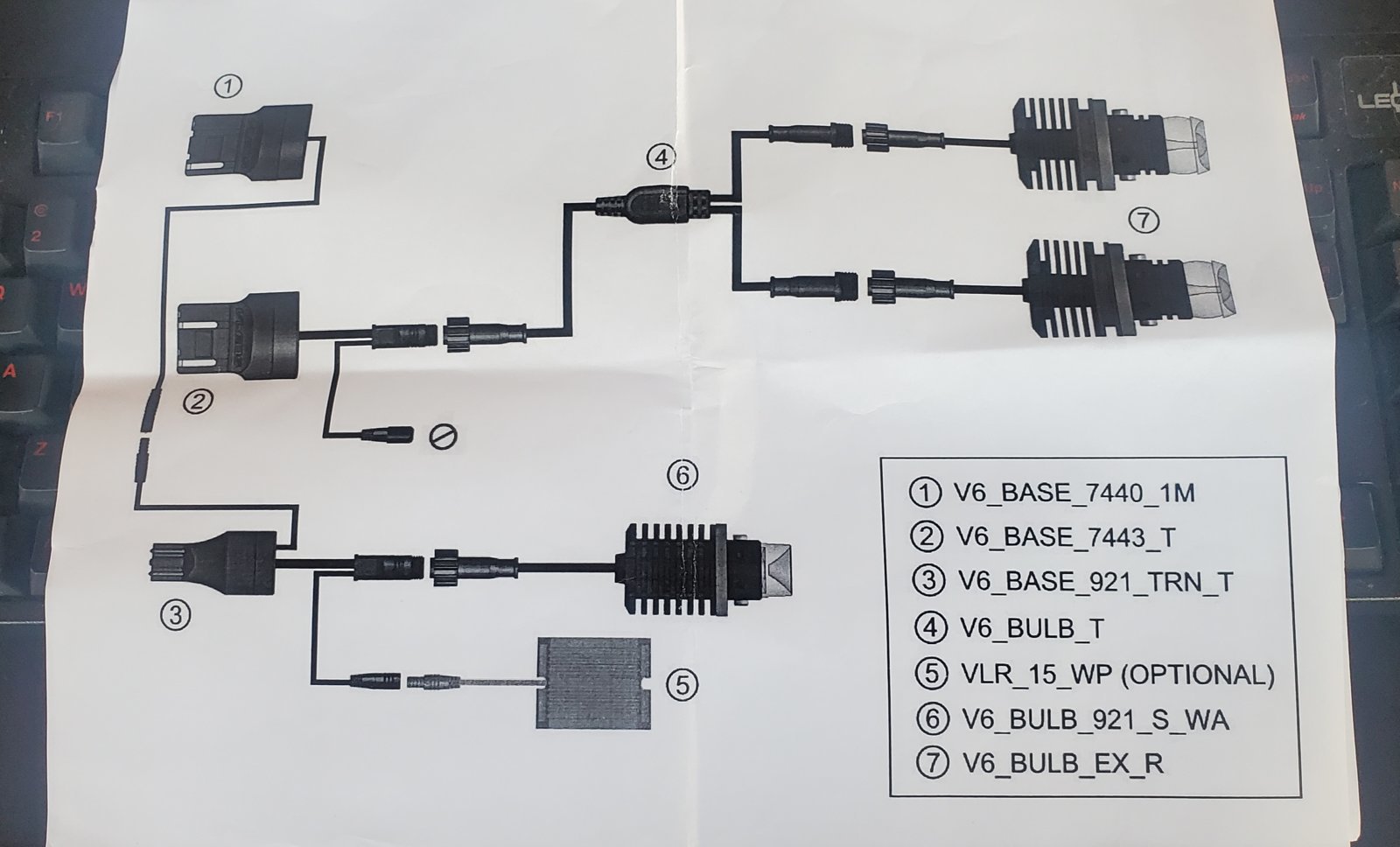

    Without the T harness connected, all the lights function as expected with the reverse light switching between amber/white. I'd wager this is a rare case of these two mods coexisting since the VLED kit is ~$425.
    Either way I called them today and was able to order the newer harness(es) that plug directly into the Toyota loom without any bulb-plug shenanigans. I'll give it a test early next week to see if that clears things up.
    Here's a pic of the wiring diagram, they don't seem to list it on their site:

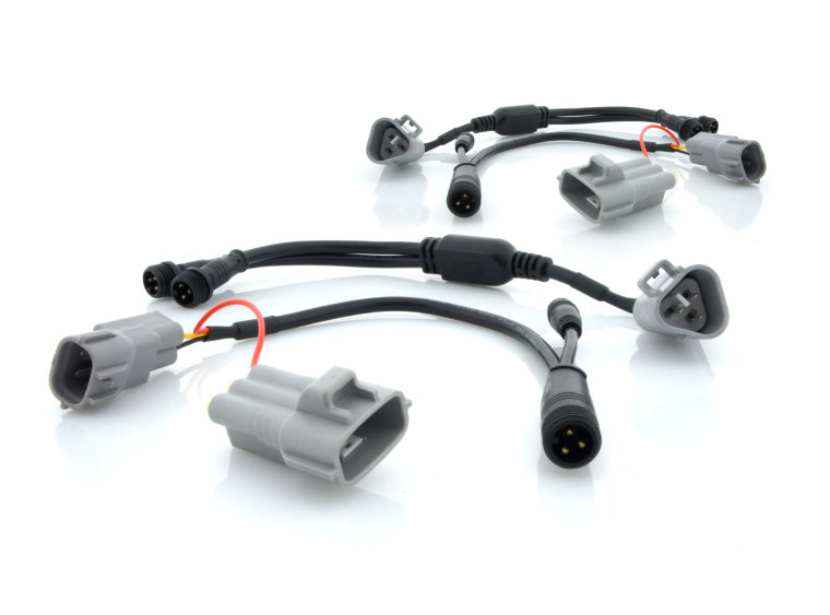

    Last night I connected the lights using the new VLED harness that plugs directly into the taillight harness to replace the old style VLED harness that plugged into the light sockets.
    Here is an example of the old style harness:
    Here is an example of the new style harness:
    For whatever reason, using the new style VLED harness solved the issue and now DIR works as expected and plays nice with the reverse/turn white/amber combo light.
    This will probably never be an issue for anyone else due to how rare I assume this Triton VTails setup is, and the fact that the problem is apparently caused by a harness no longer in use.
