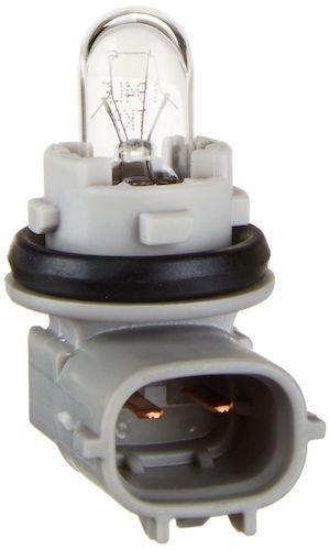

    Does anyone know the plug type for the license plate light (left, driver side). It plugs into the the following:
    Not the light bulb side. The plug socket side opposite of the bulb with the 2 prongs in it.

    Drainbung, thank you for responding it is much appreciated but I am not in need of the part pictured above. I need the other side that plugs into the part pictured above. If it plug as a name that would be much appreciated, too.

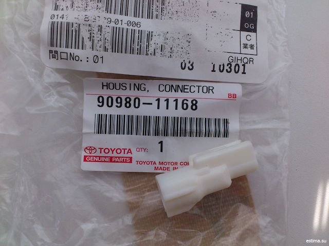

    The PN I posted is the plug-in to that socket.

    Have you verified that by searching google or ebay for that part number?
  10. Feb 4, 2018 at 9:21 AM
    Drainbung
    Drainbung Somedays you are the show....
    Sep 2, 2010
    #42629
    9,114
    Bob
    Fallabama, NV
    10 DCLB
    TRD Fleshlight
    Don't have to. Those are from the parts I bought at the dealership.
  11. Feb 4, 2018 at 9:50 AM
    Muddinfun
    Muddinfun Well-Known Member
    Apr 17, 2017
    #216500
    7,491
    So.... pick 1
    1. Your dealer is right and everyone else on the internet is wrong.
    2. You are mistaken about what came in the package you just dug up.
    3. The part you bought was in the wrong package.
    4. The new guy in this thread posted the correct part number.
    5. You are so confident that your number is correct that if the wrong part shows up, you will personally reimburse the OP.

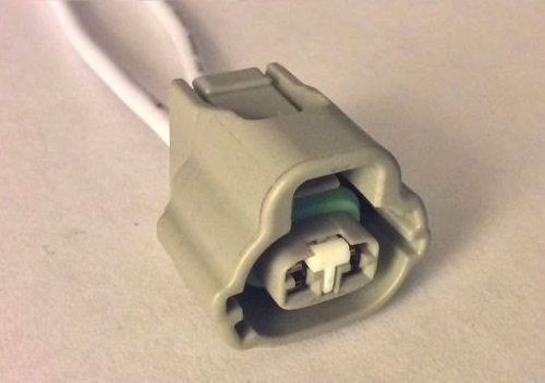

    Good job. I was able to find the connector number, but wasn't able to find the pigtails. Do you have some magic source for determining which pigtails fit which connector?
    Here is a chart that shows the connector numbers.
    http://www.customtacos.com/tech.old...oyewd/06toypdf/ewd/2006/tacoma/l/em01d0up.pdf

    Those are the plugs that correspond to the PN I listed.

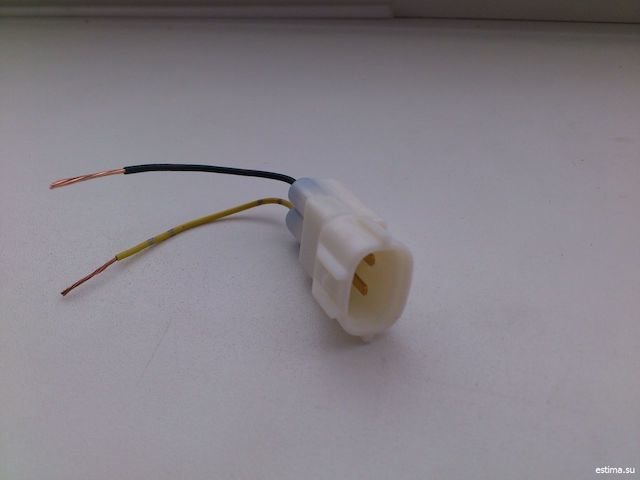

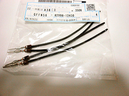

    You can make up a correct plug that looks like the connector end of a lamp holder using a 90980-11168 housing and 2 x 82998-12430 pigtails.
