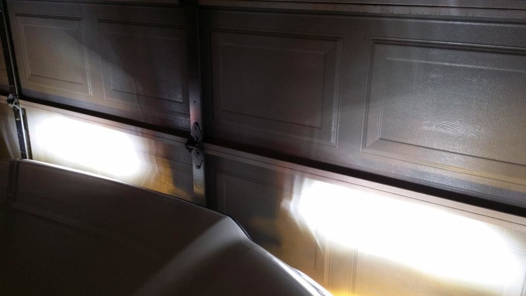

    After the passenger side was installed I flipped them on and the results were dramatic. It is a pure "white" light. The drivers side is not a stock bulb but a Sylvania zXe bulb and it is extremely white but nothing compared to the LED's.

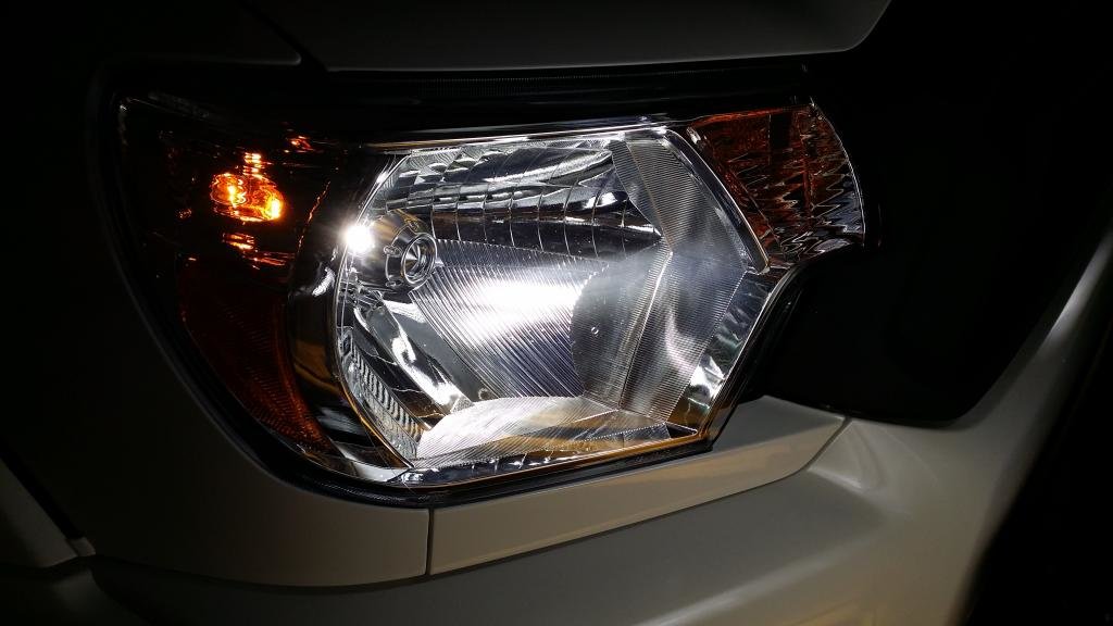

    Finished product on Drivers side.
    Both bulbs working
    I'll post better pictures later tonight once it gets dark. I drove for about an hour with them on with no heat issues coming from the back of the bulbs and I could see the reflection in the glass of building that I was driving towards. I can not emphasize just how white these lights are.
