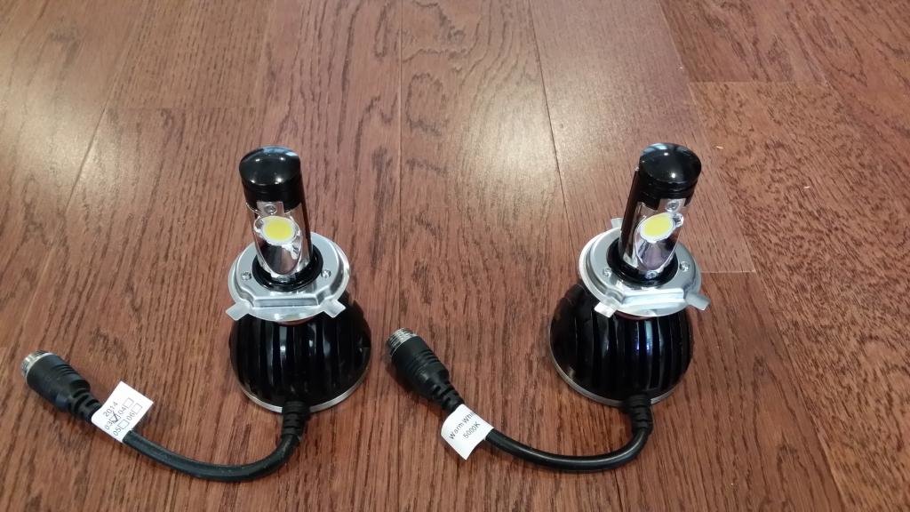

    As of 11/4/15 1) Tailgate Anti-Theft Mod 2) ND4SPDBP's Fog Light Mod 3) Devil Horn Emblem 4) Weathertech Digital Floor Liners 5) ADD W-1 Vers 2 Baffled Oil Catch Can- constantly surprised at how much oil this thing captures 6) Weatherproof Under the rail LED bedlights Warm White (by Mattgecko) with hidden small cubby switch 7) Sliding Window Security Bar 8) Hood Lighting Kit Warm White /Pro Kit (by BeeRad) 9) Morimoto mini D2S retrofit HID lights w/ 55W ballasts and XB 5000k bulbs from TRS- one of the best modifications I have ever made, blows the stock lights out of the water 10) ImMrYo bracket 11) Scangauge II 12) Autodimming mirror w/ Compass/Temperature/Homelink 13) Bedrug Mat and Tailgate rug. 14) Pop n Lock Power tailgate lock w/ bolt coded to factory key. 15) Map Light w/ Door Mod 16) BakFlip HD Tonneau Cover 17) 35% Front windows ceramic tint - a very good match to factory 19) Gerber machete, because every truck needs a machete 20) Various flashlights, really love my Black Diamond Miner Mole Headlamp 21) AFE Pro Dry drop in filter 22) removed secondary charcoal air filter 23) Back up light Mod- I used the light bulb as found on page 14, 35W from Lowes. https://www.tacomaworld.com/threads/886-backup-light-mod.209578/page-14 24) Hi-Lift Off Road Recovery Kit- thank you TW Secret Santa 25) Tailgate Seal 26 interior footwell/rear seat dome light controlled LEDS https://www.tacomaworld.com/threads/footwell-and-rear-seat-led-light-dome-switched-mod-lots-of-pics.409428/#post-11529460 27) pelfrybilt aluminum front skid 28) morimoto XB fog lights 29) mob town front recovery bar with 2 Smitty bilt D-Rings 30) 48" Extreme Hi-Lift Jacks w/ ATO rail mounts 31) Prinsu rack 32) Rigid D2 Ditch lights 33) 40" Heretic LED bar on Prinsu Rack 34) Kawell x 6 side lights 2 spot and 1 wide per side 35) Rigid SRQ2 x 2 rear facing asshole/backup lights 36) NSA switch panel to 150amp bussman fuse on custom made mount 37) 267/70/17 BFG KO2's in C rating Pending installation 1) Rock Lights Upcoming/Possible Mods 1) Katzkin Leather Seats in black/ice grey (supposedly better factory match for the 2014) w/ Degreeze heater/cooling and TRD stitched into the seat faces thru jhuey - once I get to Arizona will buy them and have him install them 3) Total chaos UCA's 4) Kinda want to get some of the 2016 TRD Sport Rims or the grey TRD wheels the FJ cruiser/4Runners have. 5) BAMF LCA Skids 6) ICON or KING coilover 8) BAMF hidden grill light mounts 9) 20" or 30" LED light by Rigid Industries for behind the Grill. . 10) full leave pack maybe the Deaver 10 leaf set 11) ? Warn m8000 winch- really depends on if I end up doing more off roading 12) Possibly a console vault, not entirely convinced those are as secure as they would have you believe.
    Ok I'm confused. I'm half way thru installing my Lifetime LED's. I've got one installed (what a pain that stupid boot was) and I go to install the other but it won't go in the same way (cord pointing down). Look at the metal prongs. One the cord goes to the left, the other it goes to the right. The one with the boot on it seems to fit the "right way" with the cord going down. The other one....well...it wants me to install it with the cord pointing upwards for the little metal prongs to fit appropriately.
    Heres the side by side. You can see that the LED's are offset they aren't the same. Yes the cords are going the opposite directions but the metal brackets that hold it into place are both doing the same directions. I've got a feeling I've got a "backwards" LED. Henry.....anyone.....

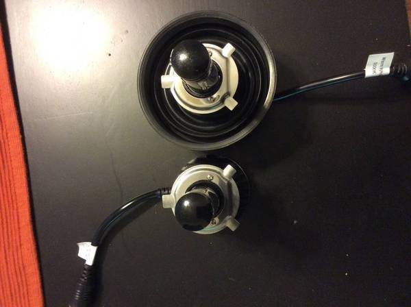

    Picture of mine. Identical bulbs. Cord goes out the bottom on both sides.

    The wires are oriented the same on the bulbs in.relationship to the hi/low. I would check the locating ring
    and make sure it is oriented correctly. It looks like it may be on upside down.

    Yup... I think he has one of the rings on up side down.

    Doubtful.
