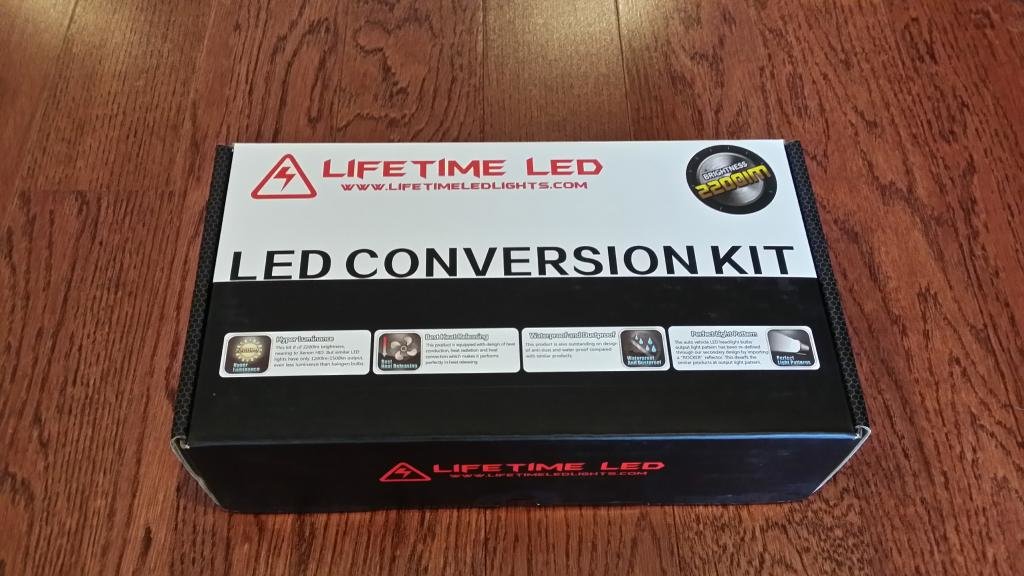

    RearViewMirror [OP] Saw things so much clearer once you... were in my
    Apr 13, 2013
    #102010
    24,080
    Craig Christ
    State of Love and Trust
    2023 Subaru WRX GT Manual
    Lifetime ;)
