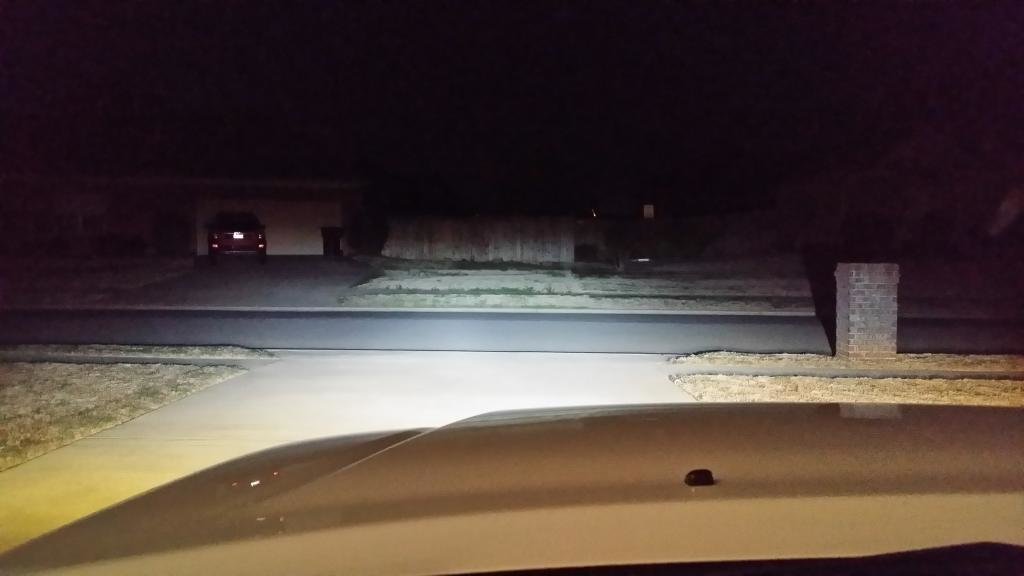

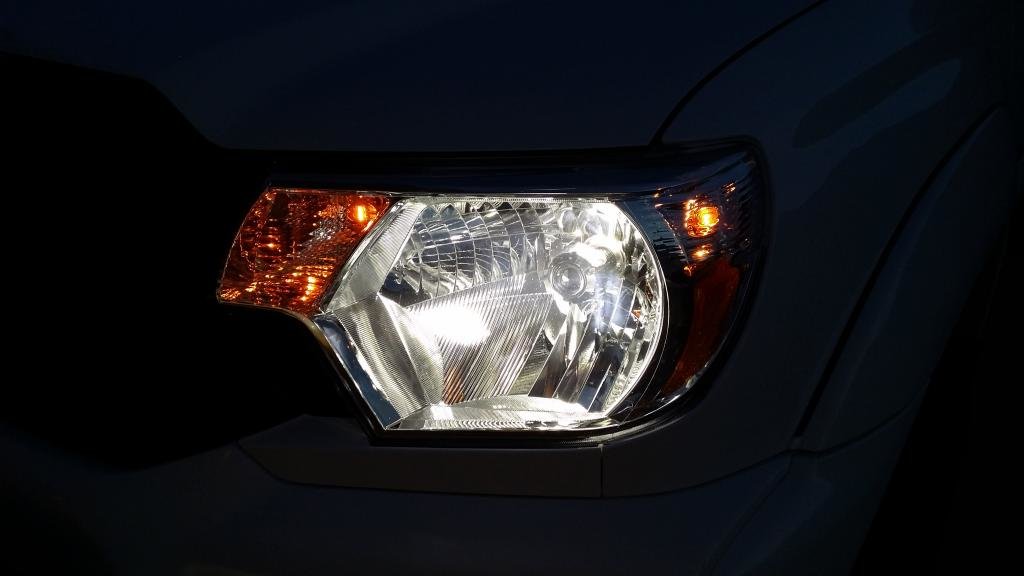

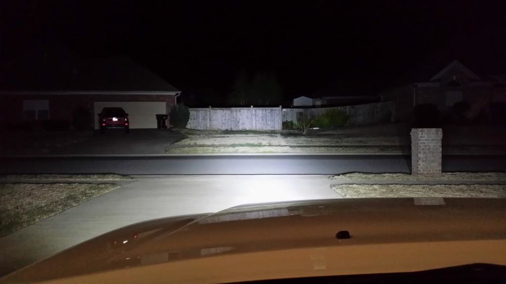

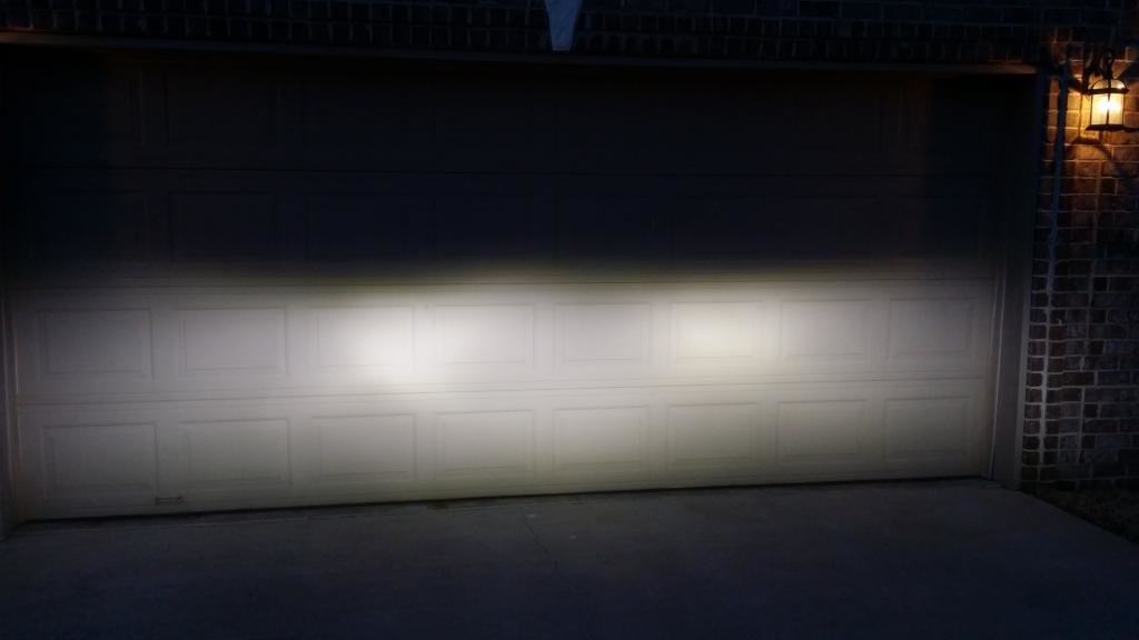

    Okay, It's not completely dark but here is the truck 20' from the garage and the light pattern is pretty nice without much bleedover. Not a whole lot different from stock with the exception of being extremely white. 30 mins and I'll try to get some light on a closed road. So far... Very happy.
    On a side note.... the nerd in me likes to hear the fans running while the lights are on and the truck is off.
    Low beams no fogs
    Low beams with fogs
    It's really hard to get a good shot of just how white they are. You'll just have to trust me

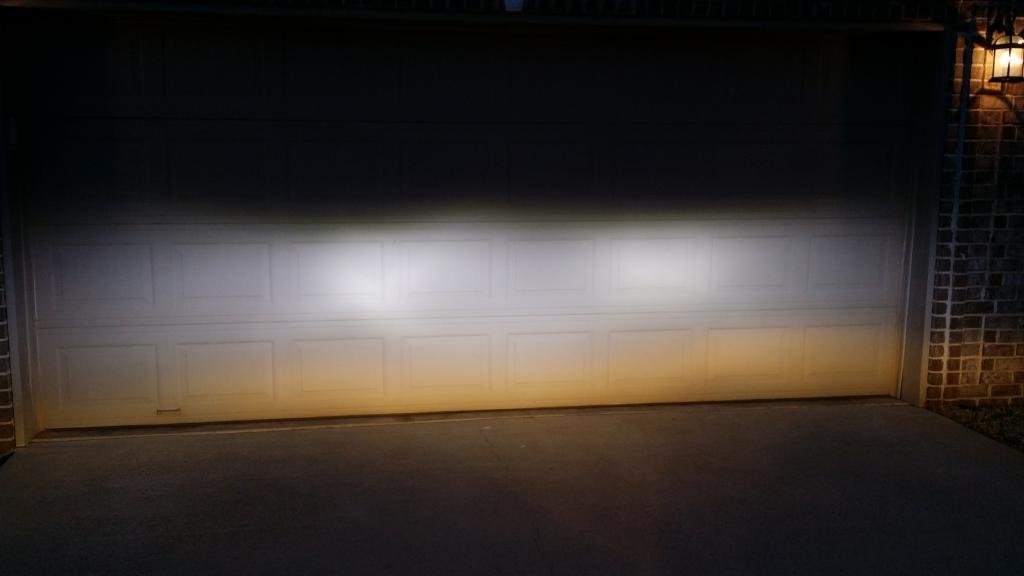

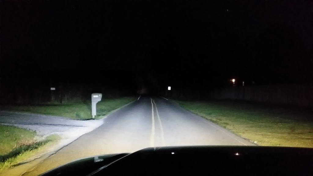

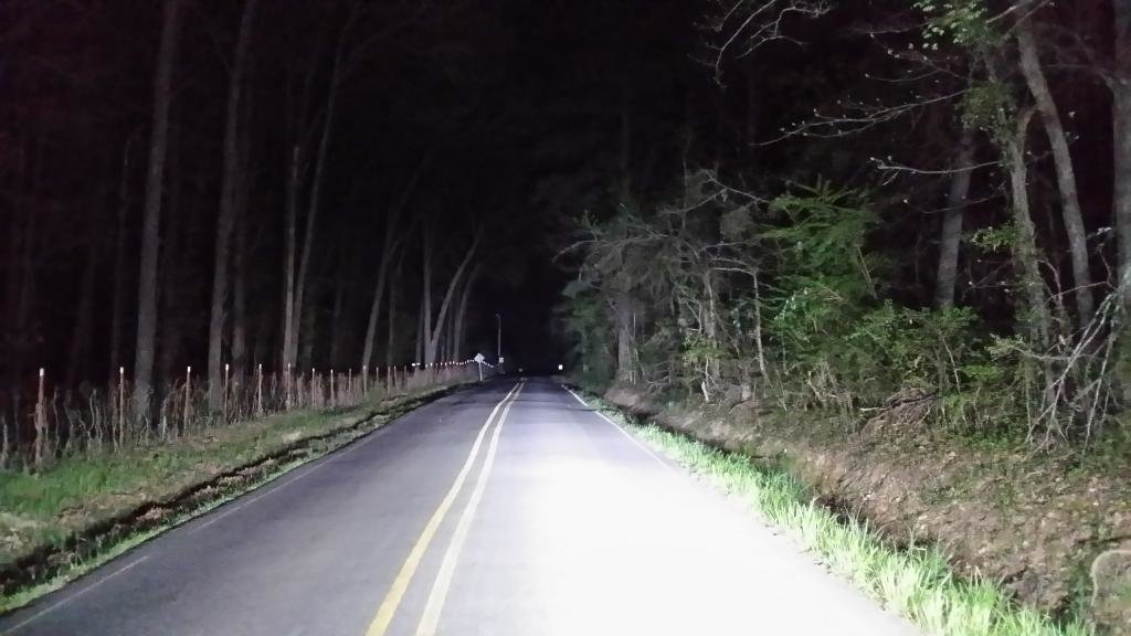

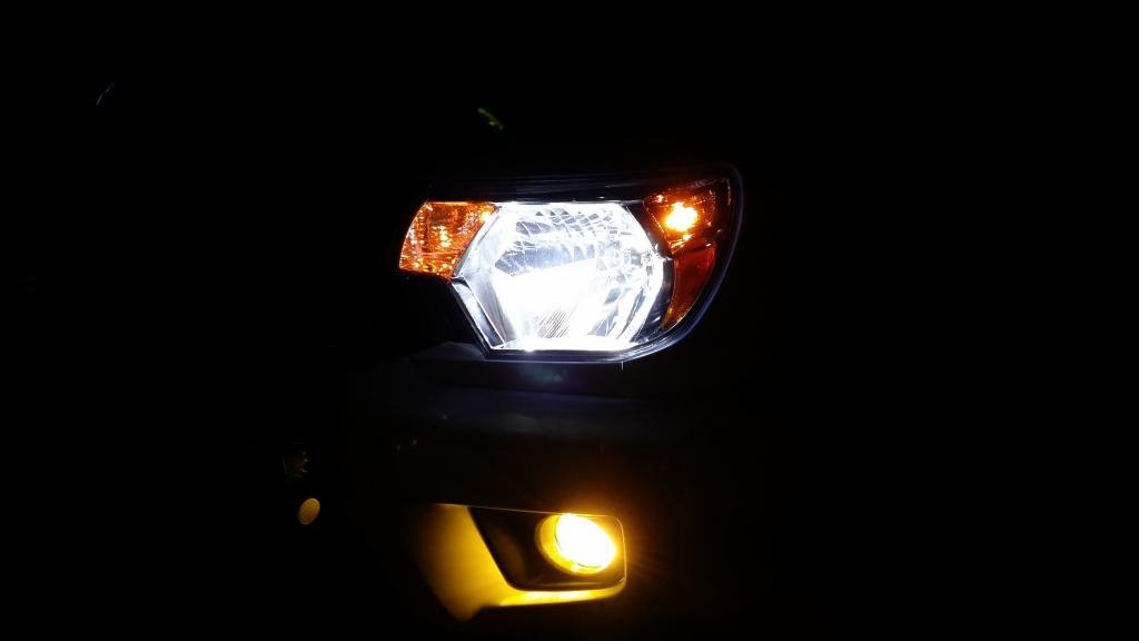

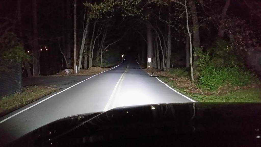

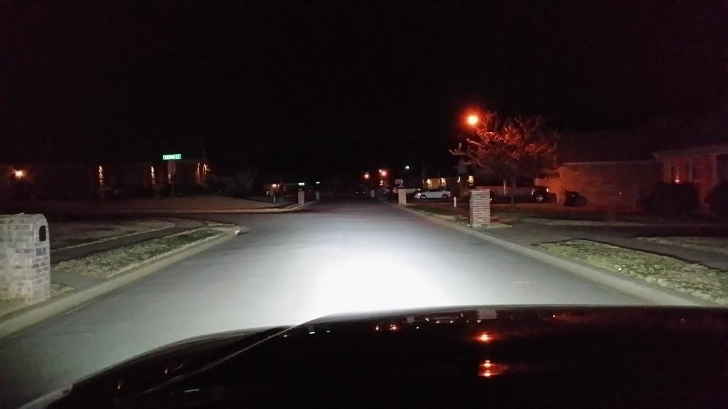

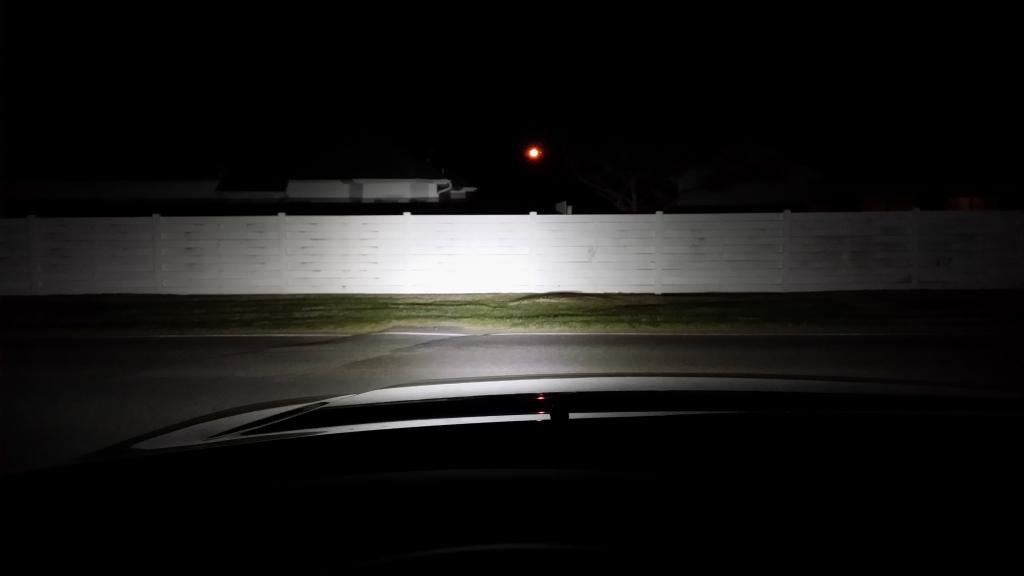

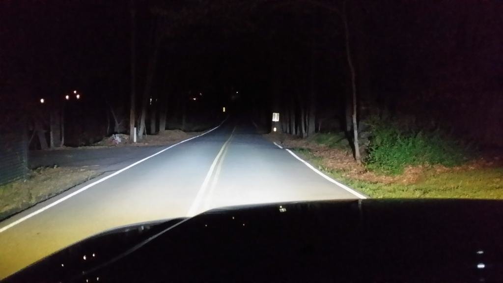

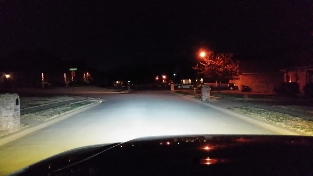

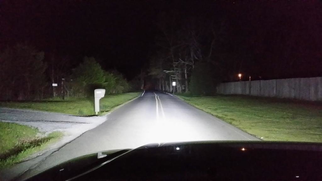

    Okay I'm sold
    Leaving the neighborhood
    High beam on dark road
    Low beam (sorry for picture quality)
    High beam same spot
    Low beam
    High beam
    LED light with Nokya Hyper yellow fogs
    Neighborhood Low beam
    Neighborhood High beam
    Garage Low beam
    Garage High beam
    I am completely happy with these. Truly plug and play with no blinding or flashing from other drivers. Now for longevity. Money well spent.

    Impressive. If they're still holding up come next Sep/Oct, I can see myself doing this. Not much point in making the upgrade coming into Summer up here. I rarely turn on headlights, except fogs as DTRL, from about May thru Aug. ;)

    I think this is the top write-up on these thus far. Good beam pictures finally.
    I do like the high beam on these compared to stock. I don't care for the high beam pattern on stock 12+, if it is even different from 05-11. These look to put out a better high beam distribution.
    I will wait, like others, to see the longevity on these things since they are not as cheap as regular bulbs.
