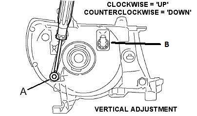

    "A" up and down
    "B" side to side
    Don't fuck with side to side too much.

    I'm pretty happy with the up/down, I'd just like it a littttttle more to the right on both of them. Is that screw behind the rubber boot or is it outside the boot? I don't remember seeing anything quite like that when I put them into today.

    You have to remove the rubber / plastic? tab. Then turn to get your desired projection. In all seriousness.... do not move those too much. You will run the risk of blinding on coming drivers if moved in the wrong direction. If you have any doubts take it to a professional that will be able to line up your lights exactly like you need them. Up and down is risky enough.... side to side can be down right dangerous.

    Understand. I definitely don't want them up any more. I just want a littttttle more to the right. I found a PDF on here that outlines drawing lines and centering, etc I may use that as a guide. I certainly don't want to endanger anyone!

    The up down is behind a black plastic boot near the top of the housing, hard to miss.
    The side to side is a metal wheel that fits a size 10mm socket if I recall. Its halfway down as shown in the pic and is hard to reach.
    Aiming headlights is about as tough as doing your oil. There's many online guides for doing it, but I have found this one to be the best

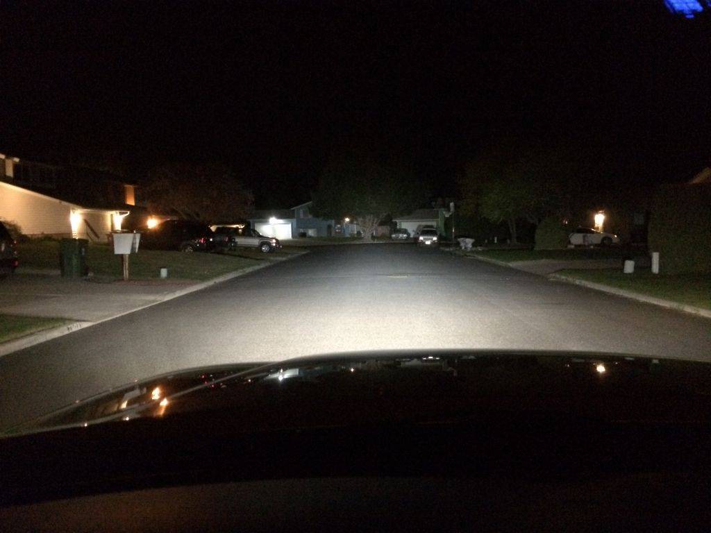

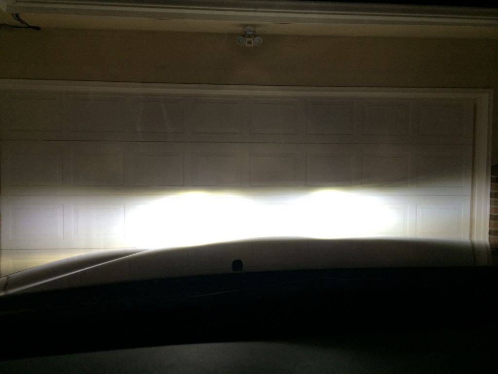

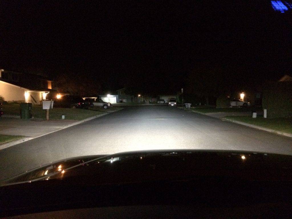

    I removed the lights out today the trimmed the rubber boot a bit. Also the top alignment tab on one of the bulbs was bent so i straightened it. I also looked at the mounting plate and it was not straight like some of the other pics. I corrected that and after putting the lights back in with less pressure from the rubber boots the results are MUCH better for the low beams. the high beams are still nothing to write home about, however after readjusting them the cuttoff line is back. I think the 2012 and up do a little better job of focusing the light I am completely happy with the end result in my truck being a 2008. I will probably end up putting some in my wife's Corolla as well in the next month or so as she is pretty impressed with the light output on the truck.
    low beams:
    High beams:
    Cuttoff line:

    Based on specifications, its not that surprising. Stock beams at best are 910 lumens low, 1580(?) high. So, you add 600 lumens when going to high beams.
    If specs are true, these are 2000 low, 2600 high. You get the same jump-up when going to high beams, but think this way: now, your low beams are like having a second bulb running, and is already better than standard bulb high beams.
    Just be grateful for the light you are getting, because they are either in a very grey area or completely illegal to be putting out that much light in that size if I'm reading this guys post correctly where it talks about bulb regulation
