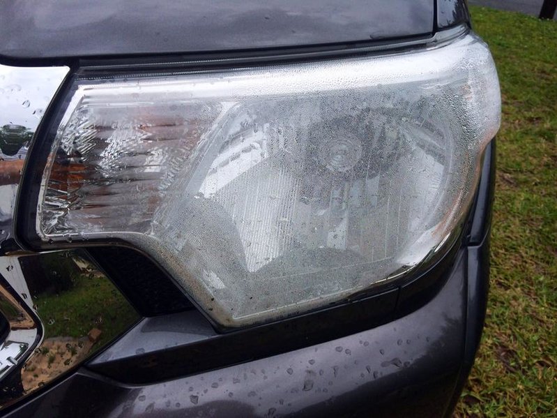

    After a couple weeks of use and last night finding a fogged up drivers side headlight after a couple days of rain I removed mine today to put back the stock halogen bulbs. The larger LED fan area must have had some rain drip onto them allowing it to seep into the headlight housings causing moisture and fog to build up inside. The LEDs were very bright and white however I just wasn't totally happy with my perceived usable light. I felt like I wasn't able to see my surrounding as well as the stock halogen bulbs. Maybe it was the color or exact beam pattern but I have felt less confident driving with the LEDS. I did cut small slits in the bulb boots for easier fit. I contacted Lifetime and hopefully I can get some kind of refund. :(
    Or if anyone in Tampa Bay wants these to try for themselves just PM me and let me know.

    You did put the rubber boot back on the light without cutting it right? I could see where "maybe" it could get in that way but I've driven in a bunch of rain since the install with no issues yet.
