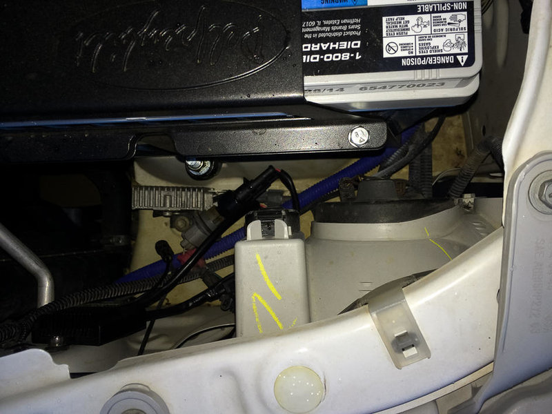

    I installed mine, purchased from Wired, this past weekend. On the passenger side I had to remove my Volant CAI box in order to get the washer bottle out of the way. On the drivers side I only had to loosen the battery (Optima Red Top) and turn it a bit to make more room to work. Other than that the hardest part was getting the boots on, didn't have to trim them. I was installing them in hopes of them being close to as bright as the HID's they were replacing, but with a better cutoff. Even though I have never been flashed running the HID's in the oem light housing, for about 2 years, I just wanted to reduce the chance of stray light blinding others. Having said all that, here are my observations: 1) the LED bulbs seemed to be of high quality 2) the LED lights were very bright, as compared to the factory oem bulbs 4) the LED's have a nice sharp cutoff 4) the LED's were nowhere near as bright as the HID's.
    I ended up putting my HID's back in for now, and ordered up some projectors lenses for the HID's. I will probably install the LED bulbs in my son's Suzuki Aerio, which uses the same bulb model.

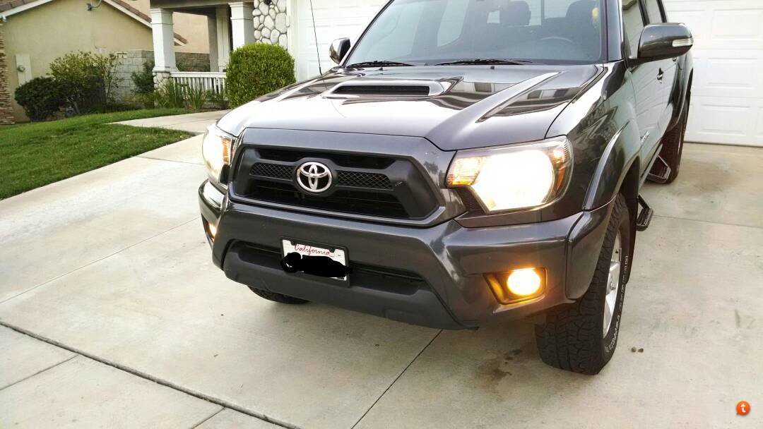

    I copied RearViewMirror and installed some yellow fog lights. I do try and only use the fogs when weather will justify it. They work great and only around $25 instead of another $150 on the fogs. He is right, the yellow with the led super white look good together. Just a suggestion.
    I bet the LED fogs would be awesome though...

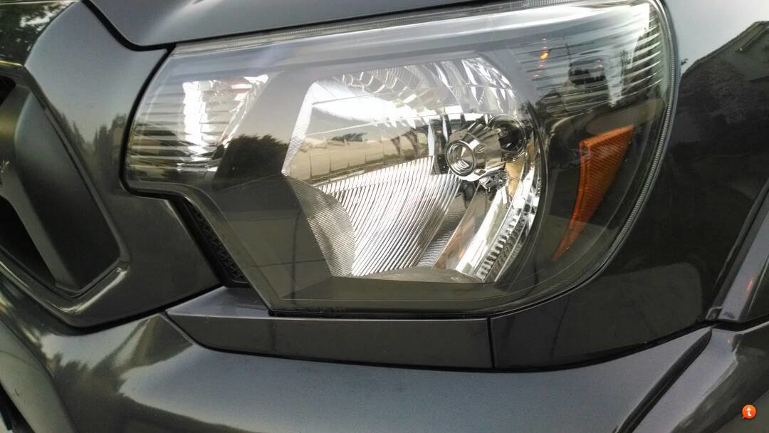

    The photo came out with a blue tint. :( For reference, the light fixture in the background is an incandescent bulb and more yellow. I assure you that the headlights are pure white and the fogs are yellow.
    Edit: The morning provides better lighting. No condensation yet, but it has been in the 100s and bone dry. Here ya go. :)
