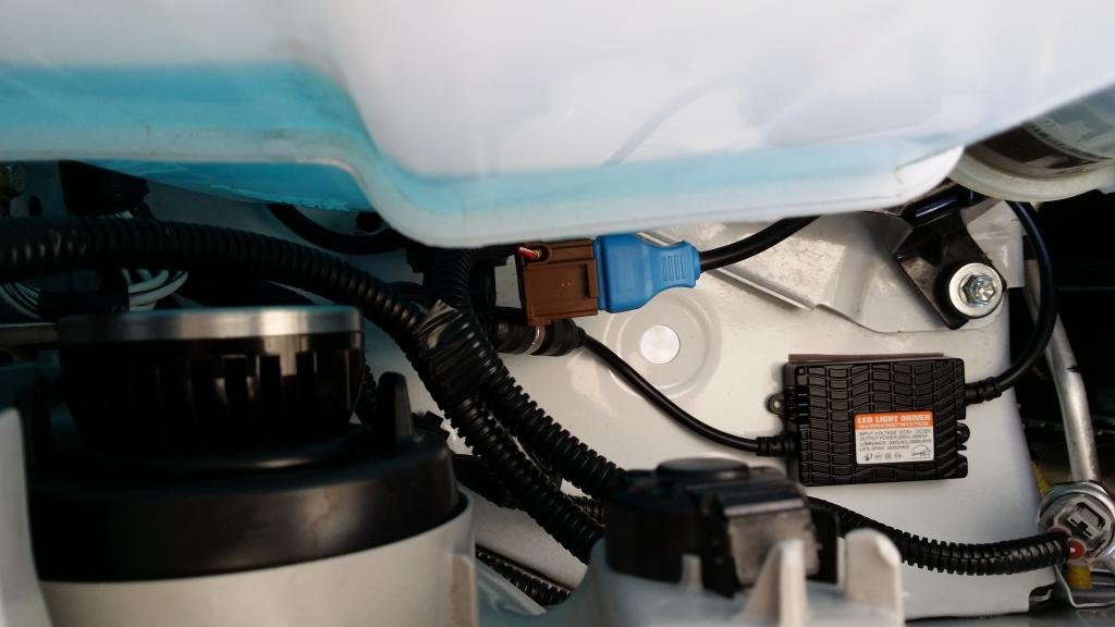

    Installed mine yesterday; super easy! It takes longer to move the washer tank and battery than to install the actual lights. They seem to be a decent amount brighter than the stock headlights in my '13.

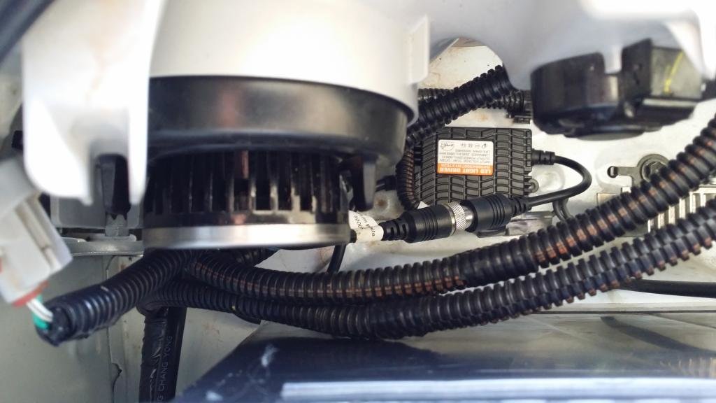

    I just installed these last weekend and noticed that after the install that when I drive to work in the morning that radio stations are coming in statically. I stuck the "power box" on the plastic headlight bucket to prevent this from happening. Any suggestions on a fix. I believe that when the lights are on its causing some kind of interference. Any info would be much appreciated.

    A few things
    I zip tied mine to the wire harness and the interference went away.

    Don't let any of the wiring touch the metal. Keep it off by zip tying it. Mine doesn't have the radio static but then again my wiring is isn't touching the metal of the truck either.

    I don't know why some have interference and some don't? I taped my "ballast"? to the metal right behind each light with no radio problems at all. It's weird that it is problem with some and not others :notsure:

    Yours may be attached to metal without actually touching the metal. The tape could be insulating the LED drivers from the metal body of the truck.
    I taped mine to the side of the headlight housings because it was a convenient spot and made it easy to keep the wires neat.
    This is not to say that the other wiring here is neat and orderly :rolleyes:. This is something else that is a work in progress.

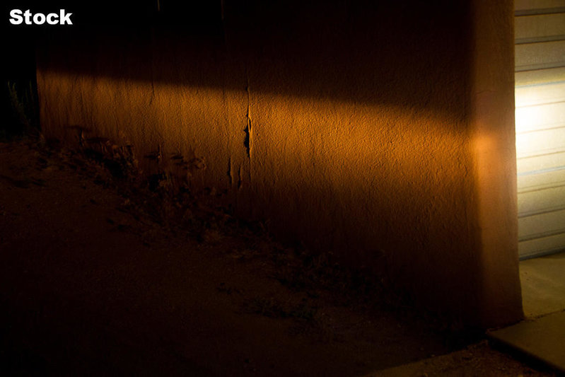

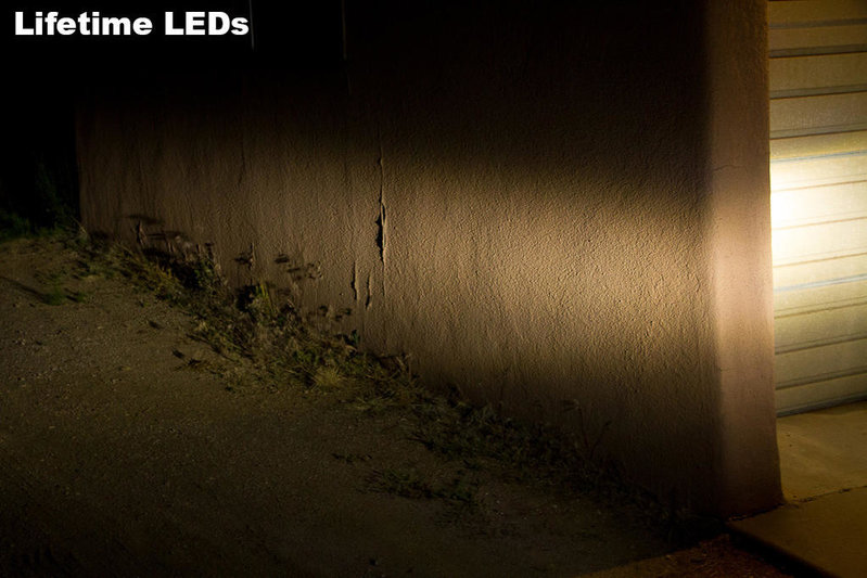

    I finally installed my Lifetime LED Headlights on my 2006 DC this evening, after buying them over a month ago. After 25 miles of night driving here are my impressions.
    Light Output
    The light is very white, as expected, about 5000k based on comparison to other LEDs. The lights do not seem hugely brighter than stock, but they are brighter. As others have noted, reflectors and reflectorized/Scotchlite signs are more visible and visible at longer distances than with stock headlights.The area immediately in front of the truck is better illuminated, with the effect being similar to the fog lights being on. The upper cut-off is not as crisp as the stock halogen headlights, but is not bad. I was not flashed in 25 miles of driving.
    These comparison photos taken at the same exposure (manual) with the white balance locked at 5000k so direct comparisons can be made on brightness and color without the camera attempting to compensate. Truck is exact same position. You can see how much whiter the light is with LEDs, how the ground in front of the truck is better illuminated with LEDs, and how the upper cut-off is not as crisp with LEDs.
