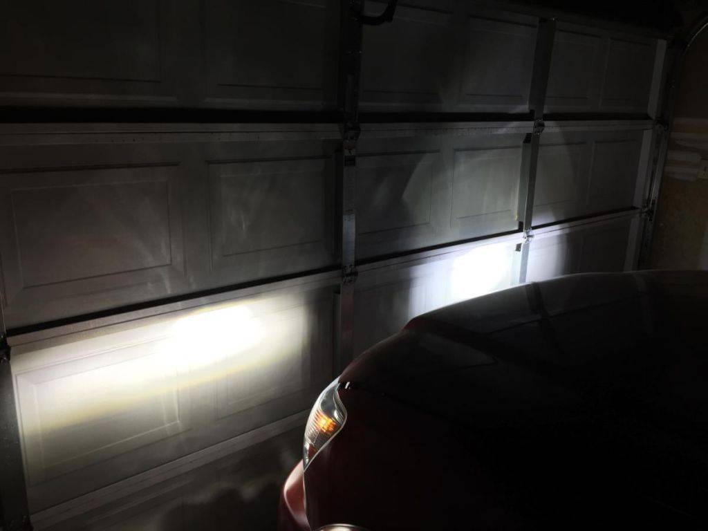

    So I got the replacement drivers and I reinstalled the lights and no more dimming. Here is a quick pick with the 35W on the drivers side and the 70W on the passenger side. The 35W is a bit more yellow looking compared to the 70W
    I also had to re-aim as the 35W has a bent mounting base, the 70W lights mount so much better. I had one bulb flicker once last night after about 30-45 minutes of run time and I already have the tracking number for the replacement. Fingers crossed they work well...
