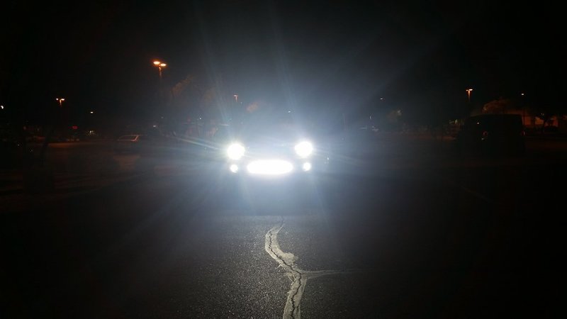

    Just installed my opt7 leds and the fogs led. While at it did the foglight anytime mod. These things are bright! 2 year warranty how can you go wrong? Always have the bumper light bar as backup
