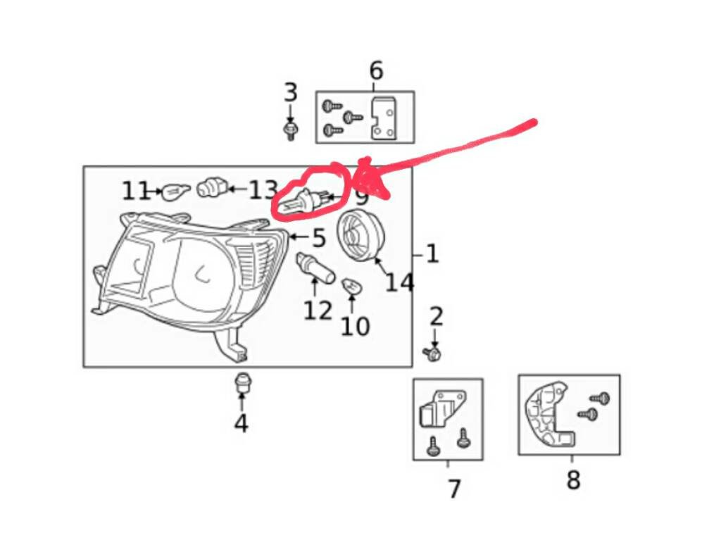

    The led headlight replaces the headlight bulb, part 9 on the diagram below. During the daytime it is illuminated, just not as bright as if using your headlights at night(...daytime running lights). While in this mode of operation a lower voltage is applied to the headlight than if they were operating while"on"at night as regular or high beams. The led headlights don't like this reduced voltage condition apparently which causes a lot of the failures according to the thread.

    On my Tacoma the headlights are either on or off. At no point on my 2013 was the light run in a dimmed mode as the DTRL. You are worrying about a problem that does not apply to the Tacoma.

    In my wifes '11 t4r on the stalk that controls headlight operation one of the positions is "DRL". If the selector is at that position the headlights come on, but are dim. When the selector is rotated to the "on" position the headlights are at their normal operational state. When I'm saying drl/dtrl I'm referring to the condition of the headlights where they are on, but dim as most late model vehicles now do during the daytime. Hence daytime running lights.
    The amber lights you are taking about are the signal/ marker lights and are not related to what I'm taking about. Not trying to argue here, just trying to share some info for people who have or are thinking of getting these.

    On the Tacoma, or at least on my 2013 Tacoma, DTRL's which are always on up here use the amber light on the inside edge of the headlight. At no point is partial current or low voltage fed to the headlights to achieve a DTRL on my Tacoma.
