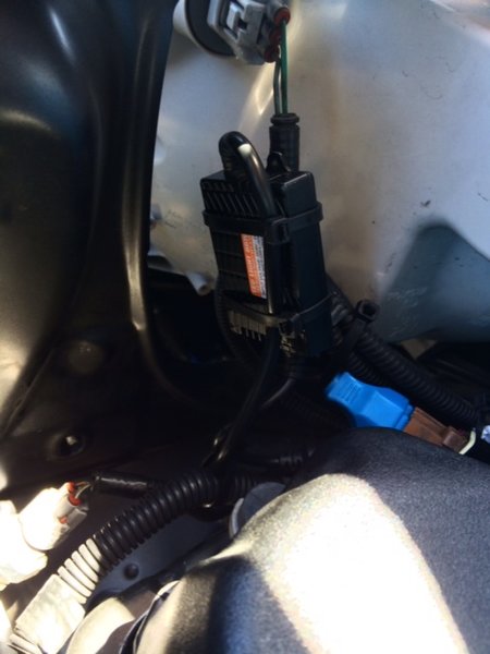

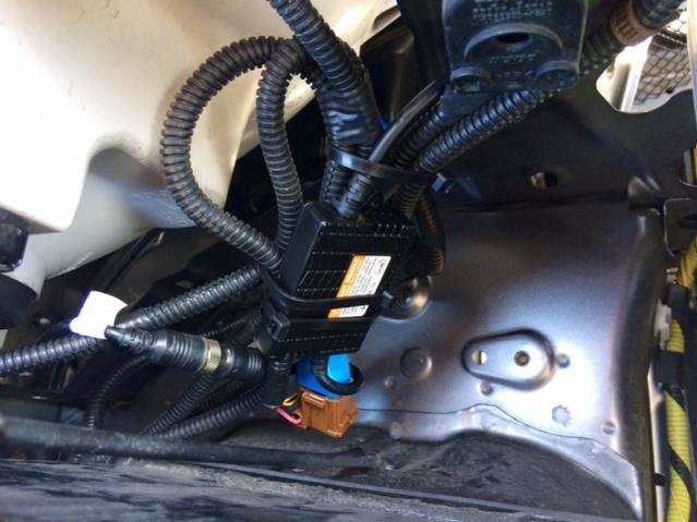

    I have the regular radio(no XM/E-tune) It was a quick fix and a few zip ties, hopefully it does the trick. I'm still at work.........to be continued:cool:

    I'm happy to report that zip tying everything up and off the metal shelf fixed my static radio problem. :woot::bananadance::bananadance::broccoli::broccoli:

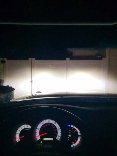

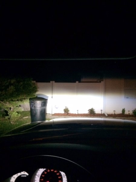

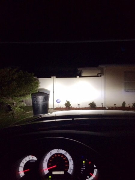

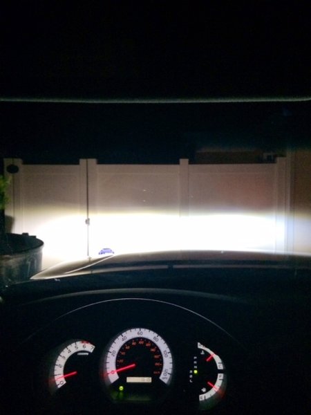

    Here's a few more night shots. The low beam has a nice cut off just like stock.
