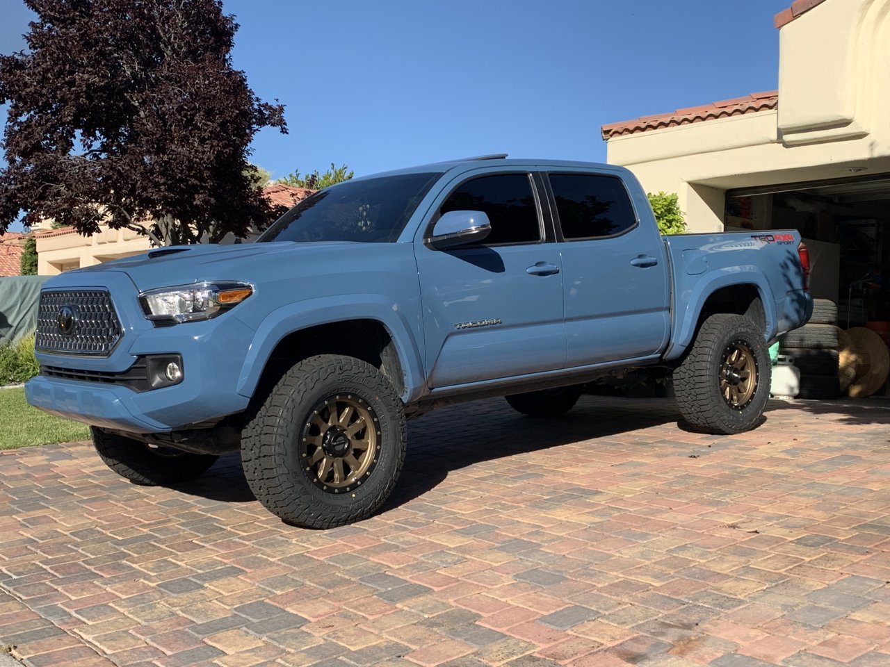

    Avid lightbar, Eibach 2in lift, various TRD parts
    That’s what I spent.. Christmas deal or something

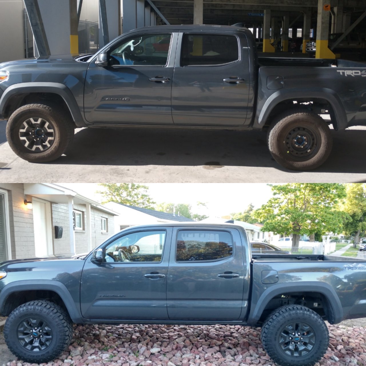

    I second this. Costs more than just spacers, but once I got it installed it has been great! I don't regret spending a bit more up front, though I thought I might when I first bit the bullet and paid for it all. It's a little stiffer, but in a good way.
    I was shooting for 2" all around and finally decided on Bilsteins in the front, OME Shocks and Dakar leaf packs in the rear, spidertrax wheel spacers, and a taco lean spacer.
    Before on stock tires and wheels
    35.25 pf 34.75 df 36.75 pb 37 db
    After on stock tires and wheels
    37 pf 36.75 df 38.75 pb 39 db
    Also, I am surprised how noticable the handling difference with wheel spacers is. Really liked how it took the corners after adding the wheel spacers.
    Just my 2 cents
