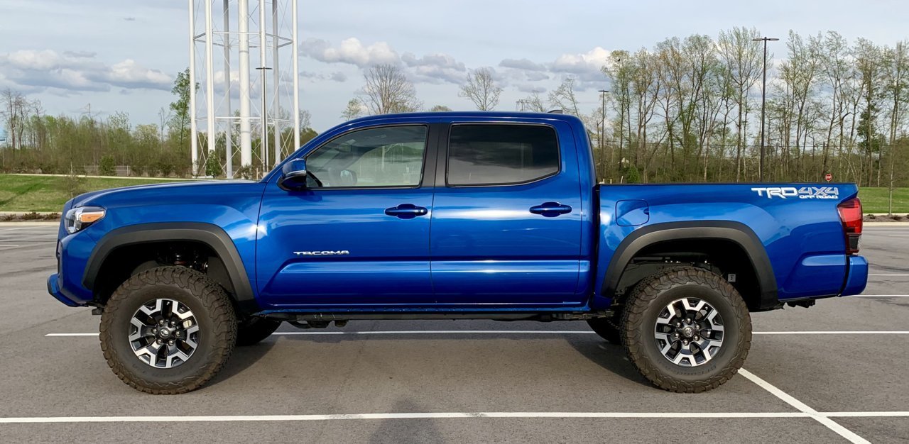

    Go with a 2" spacer. I did and its perfect for my situation. I ride 95% surface streets and lots of forestry roads with not much more technical, I have a Jeep for that.
    I did 2" front spacer and 1" rear block with 265/75r16s. Rides exactly as it did factory and was about a $120 investment with no complaints at all.

    Im getting 19-20mpg. That is down from 23ish when totally stock. I choose heavy BFG KO2s which is the main cause of the decreased fuel efficiency.

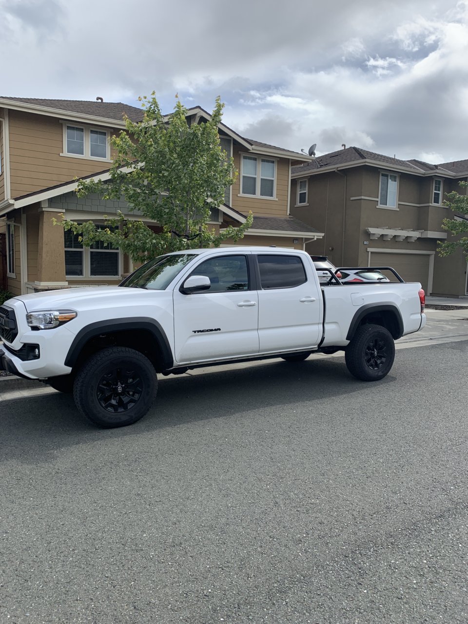

    2” front 1” inch rear still have 1” of rake. Ride is excellent. I’m a mall crawler and I don’t give a fuck LOL

    IMO the ride is like stock. For me going this route is perfect. Also if I was off-roading all the time I would’ve spent money to do an expensive lift. I don’t so why spend 3 grand to drive around just to have a perfect set up. We should all support each other for what ever we do to our trucks. To be honest I’m tired of seeing members trash talk spacer lifts. It’s my truck. To each there Own. Again the ride is like stock. I go camping and light trails. No problems at all.
