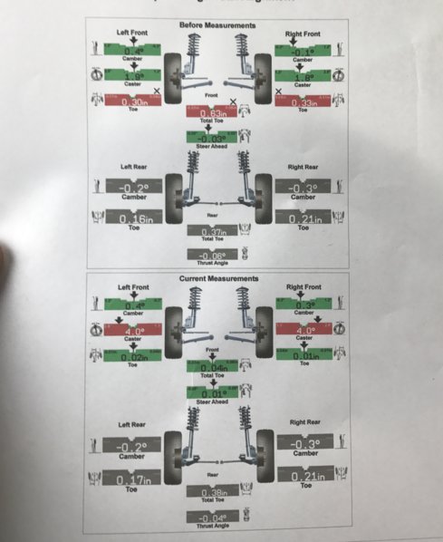

    Chris I got my truck lifted today with billies at .85 and eibach. Had LR UCA installed too.
    Caster is left 3.8 and right 4.0
    Camber is left .9 and right 1.0
    Toe is left .05 and right 0
    Is this terrible?
