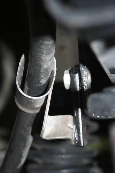

    I'm not sure how to add my pics...but I made some extensions out of some bar stock that I had around the house. Seems to work great and I have plenty of "slack" with my 2.5" lift. Check my pics...if anyone can help me out, please add them to this thread.

    here ya go........
