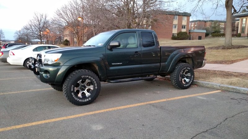

    This is my truck with a 3inch rough country suspension lift. I just put 33's under it and still had to trim a little. I don't think you could fit 35's without more lift and more cutting.

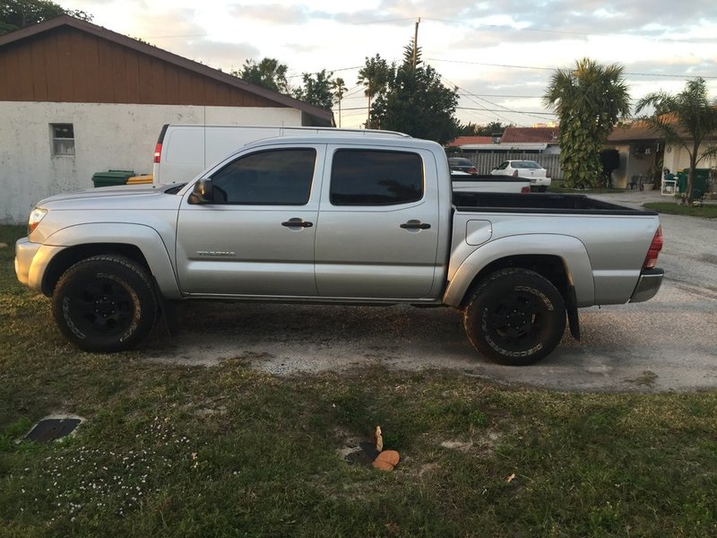

    jbrianperrin what are the specs on your rims?

    Mine are as follows:
    • Offset: -6mm
    • Back Spacing: 4.5 in.
    • Max Load: 3500 lbs
    • Center Bore: 130.81mm
    • Max Tire Height: 35 in.
    No rubbing with 285/65R18 trail grapplers
    Didn't have to trim anything either.
