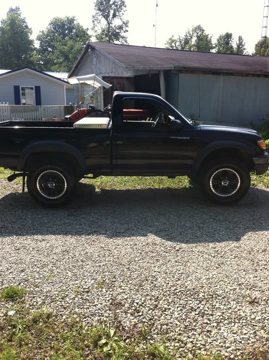

    I have an 04 reg cab tacoma right now on 31x10.5's. I would like to put a set of 33's on it. Some general tips on a good lift and some good tires would be apreciated I'd like to keep it around a grand cost wise if possible.
    This is the truck as it is right now
    254703_2359378022867_1202760054_32945226_fa8e7e840204d1041581314ebcb7226b2fecfba9.jpg

    What wheels are those? Good tires are gonna run you atleast 600$ so that doesn't leave much left for the lift. Daystar sells a 2 1/2" spacer lift tho. They call it a leveling kit. Supposedly lifts the front 2 1/2 and back 1 1/2, but it lifted mine almost 3" front and back. it cost around 140$ and double that if you're not gonna install it yourself. As far as tires, I'm a BFGoodrich guy.
    The rims are 16x8 american racing torques and I've been researching on tires and I no it wont be easy to swing but I dont figure on buying them brand new hope to find a set in good shape that I can get at a good price. Closest thing i could find to a 33 in the metric size was a 305 70 r16 but idk if these will fit on my rims. For the lift I was thinking the blistens in the front and blocks and w.e else i need in the rear.

    The rims are actually american racing fuel 16x8
