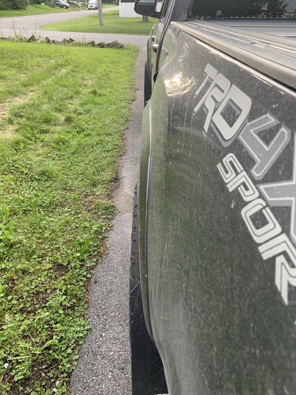

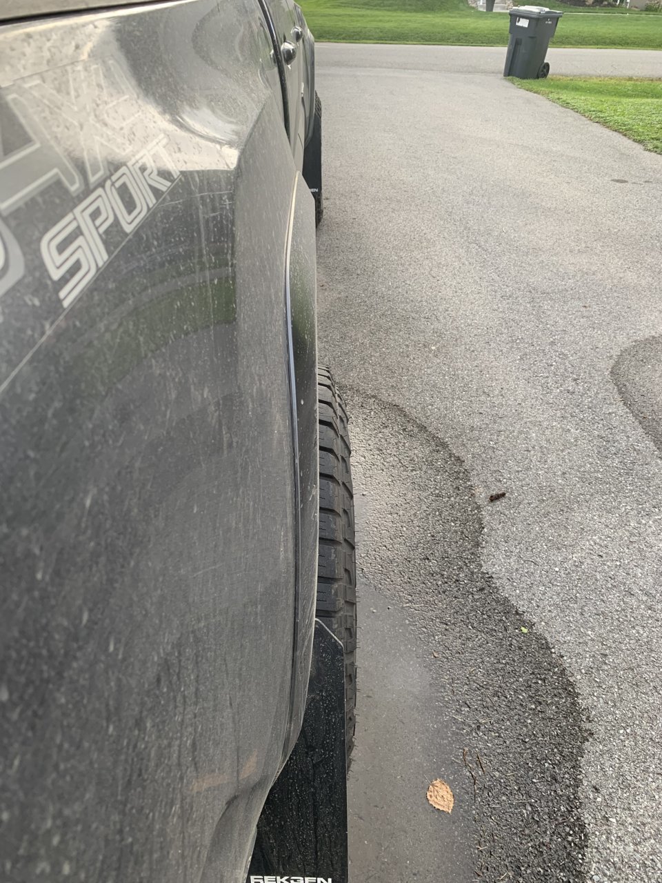

    they truck isnt on flat ground in the pic but it gives you an idea of what im talking about

    Moreso was asking for pics of what is going on underneath. Are the wheels new with this install as well? If so did you check the offsets of each of them before installing? It should be stamped into the back of the wheels.

    Judging from the fitment of your other wheels, that's all I can see as being a problem from the provided pictures unless the passenger rear has a hub spacer on it. Swap the wheels side to side and see if the issue follows the wheel. Could be a misprint.

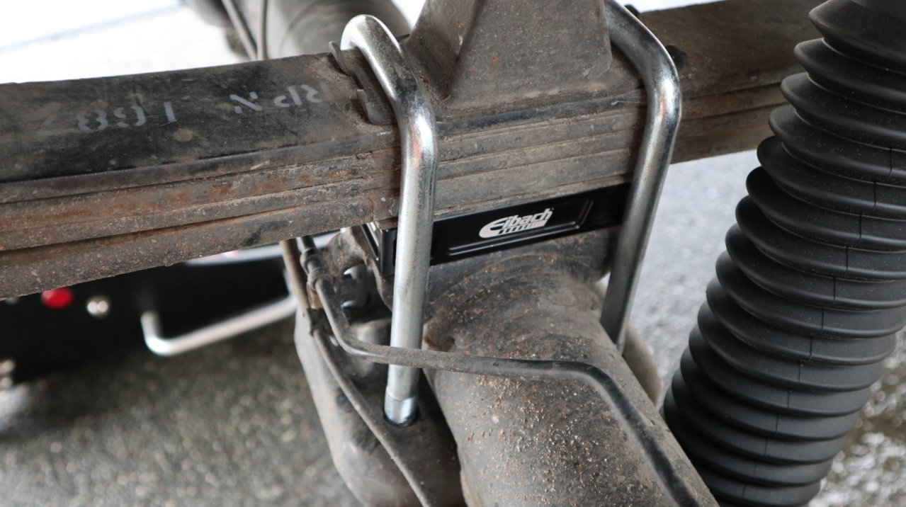

    Since a lift block has a hole and a dowel to match the leaf spring and the differential mount pad for alignment, it would be pretty obvious that there is a miss alignment between the 2 locating points.
    A simple way to verify an alignment issue with the block, the leaf spring and the differential mount pad is simply look at the 3 components from the rear. They should all line up.
    This is a side view of my lift block in my truck. You can see that they are all in alignment. The U-bolt should also be at 90° of the axle tube.
