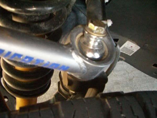

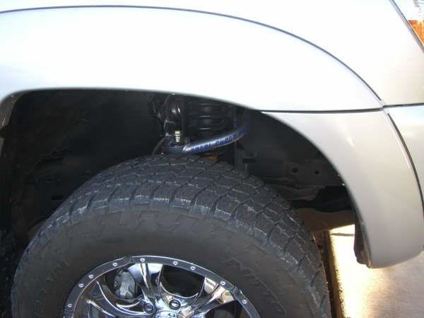

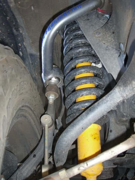

    Chris, do u have any close up pics of your tires/wheels. I would like to check the clearance.

    Is this what your looking for?
