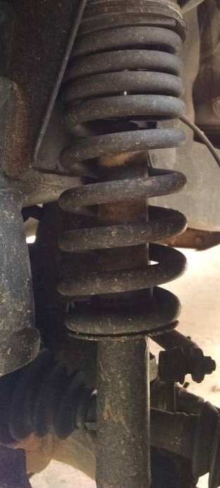

    There has never been a published OEM spring rate for 1st gen coils. The most accepted number is around 475. Brand new, TRD trucks actually sat a tad lower than the standard suspension. Note that the TRD coils are a progressive rate so a single rate number will not apply. All others are liner rate. Further the TRD coils would sag in the upper progressive section very fast and are pretty much considered worthless.
    Would you see any lift? Doubtful, even with 20K they are likely tired.
    Toyota made at least a dozen different coils for the 1st gen. Back in the day folks could get a cheap lift by putting say, V6 excab coils on a 4cyl reg cab. This usually gave about 1 inch. The OEM Billies are also considered kind of a joke.
    Nitrogen pressurized shocks do contribute to spring load and subsequently "lift". With the small diameter shock shafts found on OEM/OEM type shocks this is next to nothing. With a shaft diameter of 7/8" and 200psi this becomes more significant, about 120lbs at full extension in this case.
    Extreme case of sagging TRD coils. Note the upper coils nearly collapsed.
