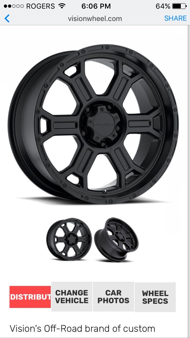

    Ya I like those rims will probobly take them.
    Yeah I'm in between the 2. I tow and use the bed so I do need the extra support if I'm lifting.

    Yeah I know. I went to diesel dr in Acton. Picked the rim above with -12 off set and backspace would be 4.5 I believe. They said slim chance of rubbing. Sounds like they just don't want to fully guarantee that I won't.
    But like your saying if it's too tall it'll hit the inner fender.
