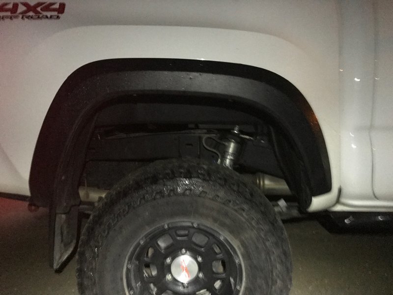

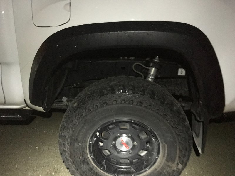

    i neglected to get before measurements, but i know the truck was sitting more or less level. Current measurements from ground to fender are:
    • DF: 36.75"
    • PF: 38.5"
    • DR: 40"
    • PR: 42"
    Based on the measurements you can see that I'm leaning to the drivers side about 1.75-2". All the settings on the coilovers and shackle flip are set the same, but looking at the drivers side UCA you can see its sitting a lot lower. I have an ARE overland cap, as well as a few tools and plywood insert in the bed totaling roughly around 300ish pounds. i REALLY hope I'm asking a stupid question here so that it will be an easy fix, does anyone have any idea what could be causing this? Any and all help would be greatly appreciated, and if i overlooked something stupid please shame me so i don't do it again!

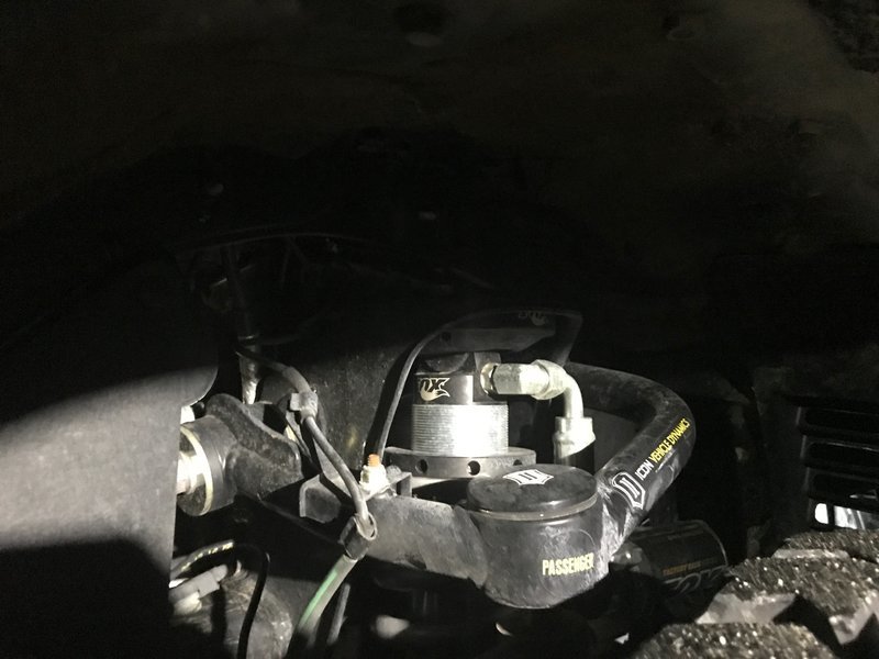

    did you count the threads above the lock ring?

    I measured the amount of threads showing, from the top of the adjustment collar to the uppermost thread is 1 3/16th inches on both sides.

    i can't imagine that the UCA's would be playing a part in anything, its all torqued to spec. haven't called fox yet, i assumed i just messed up installing the coilers and they weren't set at the same height but then went i was going to adjust them i realized they were exactly the same.
