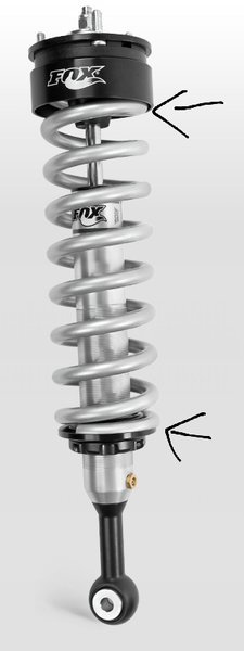

    My driver side coilover is set "taller" than the passenger side to compensate for taco lean. In the rear I bought 1/2 in rear spring shim to put on drivers side because the lean bother me some. It's only 20 bucks from wheeler's and they have 1 in I believe (I hear going more than 1 in isn't good idea for leafs but some do it).
    Sorry - This doesn't answer your question why it is 2 inches. I hear 0-1 inch discrepancy is "within normal limit range" for lift. Hopefully experienced TW member can help. Im curious too.

    it could easily be corrected for the most part by adjusting the preload ring, but that doesn't seem like the right way to do it...

    My dakers were off by 1 1/4 on the drivers side, both were marked with O. I added a 1/2" shim and you almost can't tell. You can try swapping springs left to righ and see if it makes a difference, it might if you're at 2" lean.
    On the front you HAVE to add more preload to the driver side. I have a 1/4 top plate spacer that equals .85" or actual lift, and my front is even.
    Not sure why the lean is so bad, I weighed my Tacoma on race scales, and the difference wasn't that big left to right.

    Just buy the spaner wrench, droop the front down and add some preload.
    Make sure to get the right wrench for your coilovers
