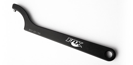

    I have the newer type C/O with the pinch screw on the preload ring, its pointing towards the inside...

    I personally would start with the front, I believe at a minimum the driver side should have 1/4 extra preload than the passeneger. I'd loosen bounce, and then Re torque the rear shackles and leaf bolts.

    Dakars are either stenciled with a plus or minus on the top , if you have one of each you put the plus on the left side if you have two pluses doesn't matter to minuses doesn't matter. When they build them they check them against the standard variation and if it's over under they put the plus or minus

    Yes sorry I didn't realize that until after I posted it , it wouldn't hurt to jack up the truck check measurements there , loosen the bolts on the suspension components set the truck it right height and then re-torque
