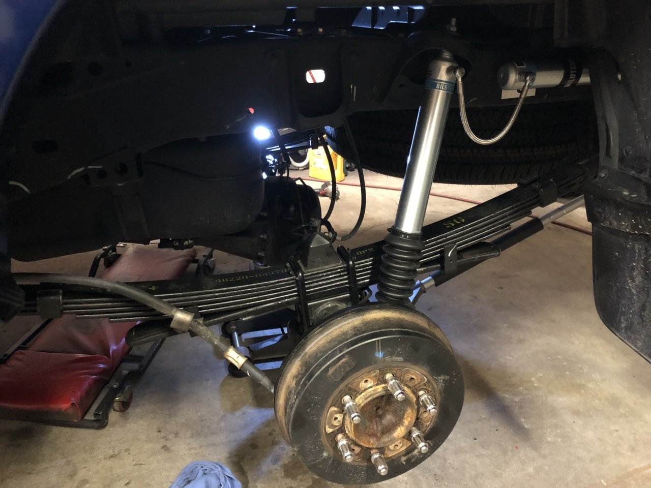

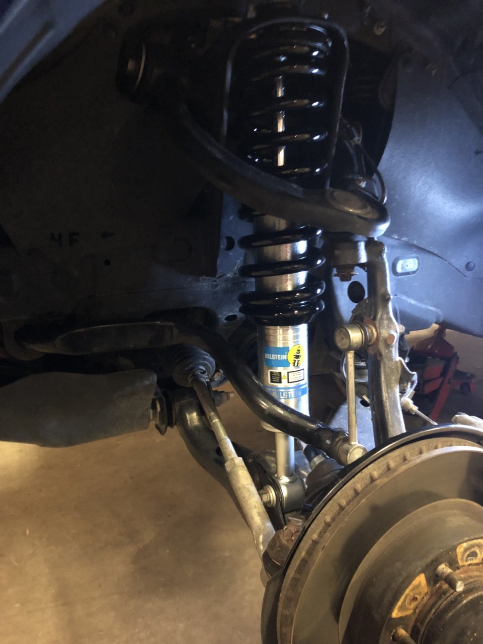

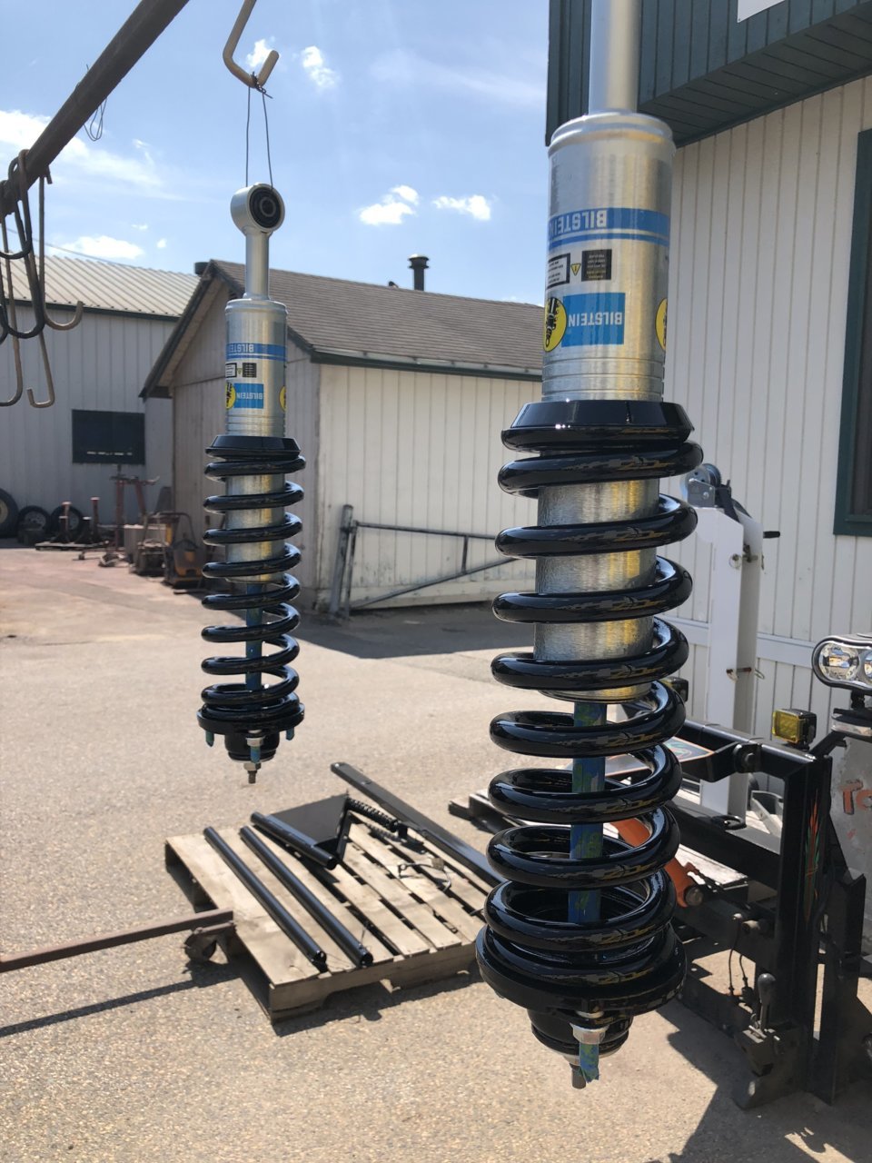

    Hello,
    @jpereira2 is correct. I coated front and rear suspension before installing. Tapped the rods and light scuff on everything. I put on 3 good coats of automotive clear with hardener. So far it’s holding up great. I’ve been driving the truck a lot more lately to see if the rain would affect it. It’s holding very well.
