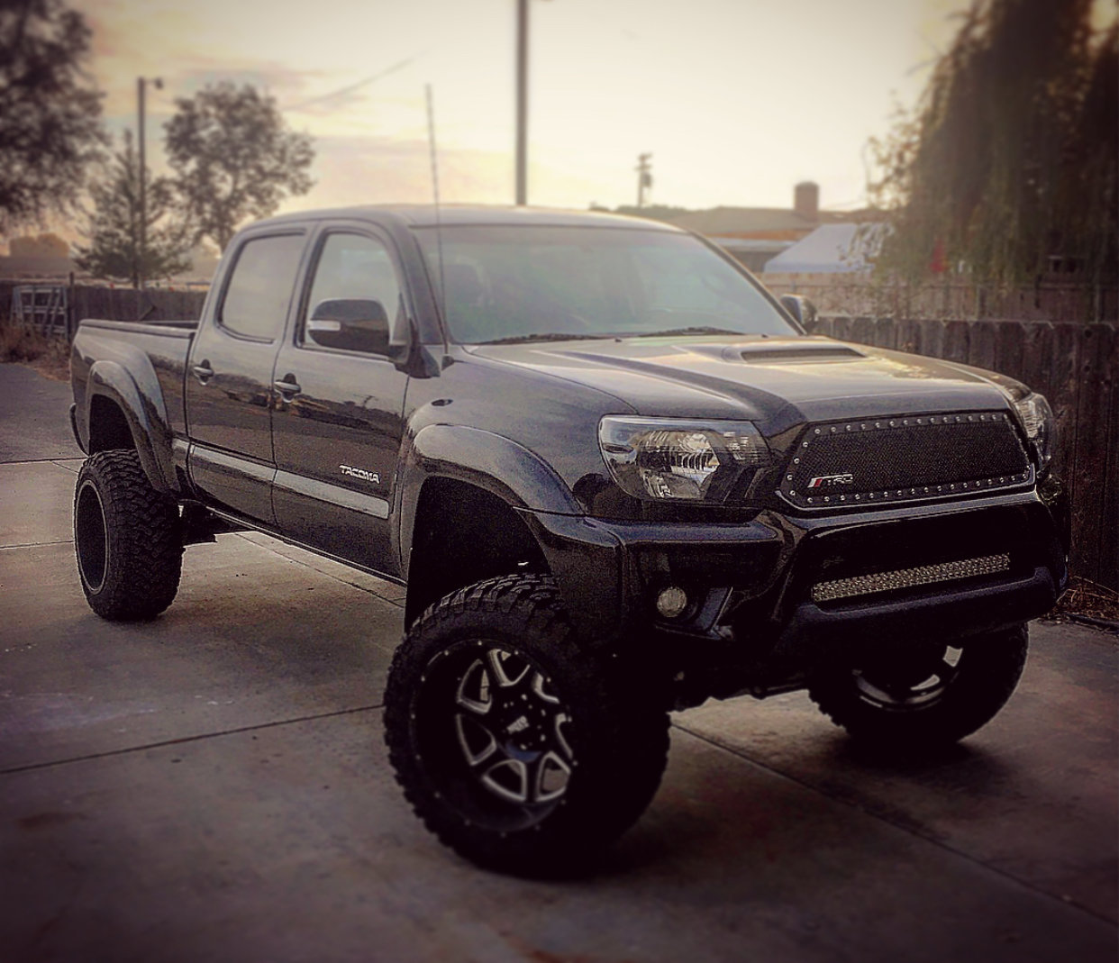

  14. Jan 5, 2018 at 4:58 PM
    Darth_taco
    Darth_taco [OP] Toyotagang_productions
    Dec 31, 2017
    #239870
    25
    Bryan
    2012 tacoma trd sport dclb
    Mully likes this.
  15. Jan 5, 2018 at 9:31 PM
    Mully
    Mully Well-Known Member
    Feb 12, 2014
    #122907
    5,141
    CA
    12 DC 4x4 Lifted Sport
    Lifted, Kings, Locked, 295s and more.
    Wow, that's real nice.
