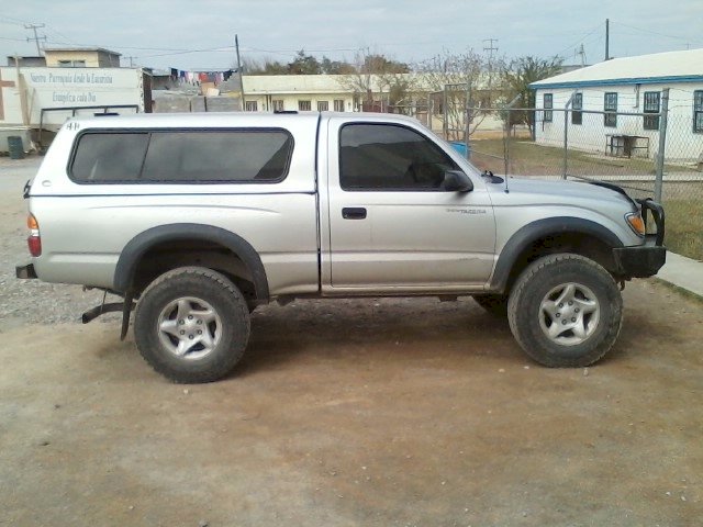

    So I was looking at the OME and it's in the price range, but I was wondering if you can tell the difference between no lift and a 2.5 lift? I want it to be noticeably different and be able to put bigger tires, can any one post before and after pics if you have them

  9. Aug 21, 2017 at 12:24 PM

    2.5" with ARB bumper and std 31" tires

    2.5-3.0" will be a noticeable difference. Your stock tires will probably look pretty small afterwards. You should be able to fit at 32" to 33" tire depending on the tire width and backspacing of the wheels you use.
