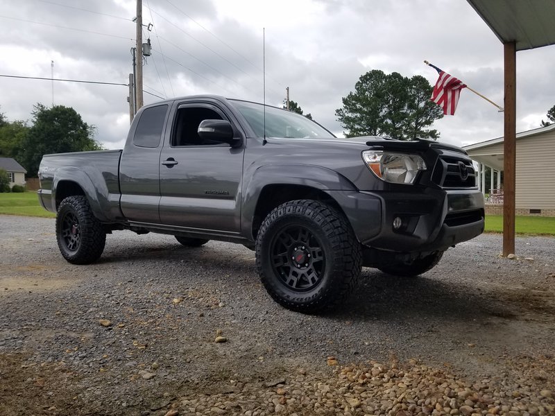

  20. Aug 25, 2016 at 4:13 PM
    #20
    TravlingmanTN
    TravlingmanTN [OP] "Nice hooters!"
    May 7, 2016
    #186352
    137
    Lynchburg, TN
    2003 Double cab off road
    Well I've got the wheels and tires installed, waiting on overtime at work to die down so I can get to the lift. But here it is minus the lift kit.
