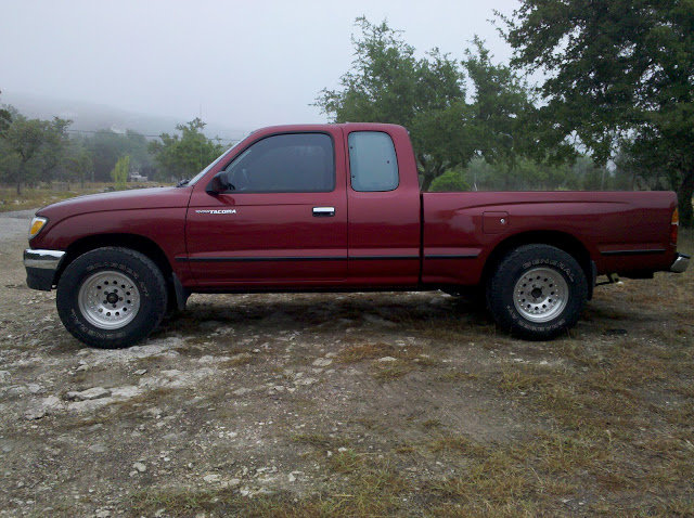

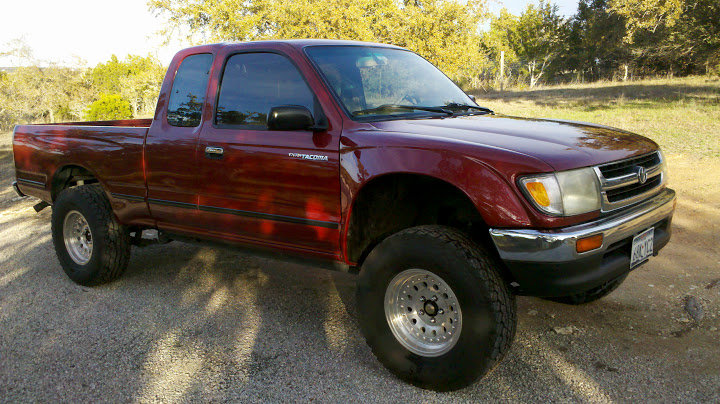

    Hello, I have a 1998 SR5 2WD 4cyl. and I am looking to lift it and put some new wheels and tires on it. I don't want it be too lifted but I want a pretty wide wheel base. Since it is 2WD and not a prerunner or a 4X4, it is at the lowest stock height. Would a 3 inch lift be enough? Also, would Series 51 Procomp steelies be good wheels ? I am not looking to put a whole ton of money into the truck, but I want to give it a bit more clearance and improve its overall appearance. The first picture is the same model of the truck I have and the second photo is the ultimate look I want. Any ideas?

    Thats a levelled 6 lug. Youl never get to that height with your 5 lugger. Best option is to sell and get a 6 lugger.

    Good to know. Is it possible to get CLOSE to that height? Thanks.

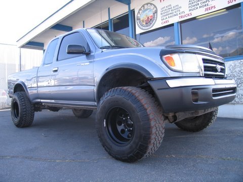

    You can get this with a Spindle Lift in Front, rear shackles, and bigger tires:
    @crazywin hasn't been on in a while, but his build is here: https://www.tacomaworld.com/threads/97-5lug-build.195038/
    The spindles will already bring the front about 1" wider, so you'll need to add spacers in the back to match width, but with that pic above he's already got the nice wide stance.
    Adding a body lift (not a great option), this is the best you can do (same build referenced):

    he needed a body lift and fiberglass fenders to clear those 31s.

    That first picture is just the rear shackles and front spindles on 30" tires. With 29" tires, spindles, AAL, and Shackles, you could get almost that same look without any rubbing.
    The fenders and body lift were cool looking, but not necessary to get 29" tires or 30" tires with a bit of trimming. If OP wants to go with 31s, then yeah, there's a lot more involved.
    Honestly though, once you're looking at going bigger, it might be cheaper to sell the 5-lug and buy a regular. I'm going to be lifting my 5-lug by 3" with spindles, shackles, and AAL because I'm perfectly happy with how @crazywin's build looked before additional lifting.
