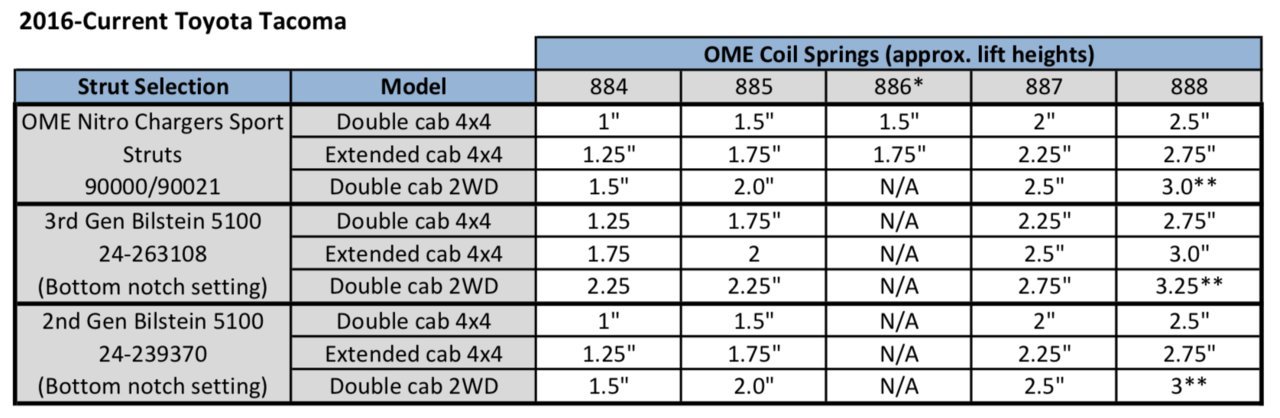

    Here is a chart that tells approximate lift. 2nd Gen numbers are at the bottom.
    joolie likes this.

    That is exactly what I needed to know. Thanks!!!
