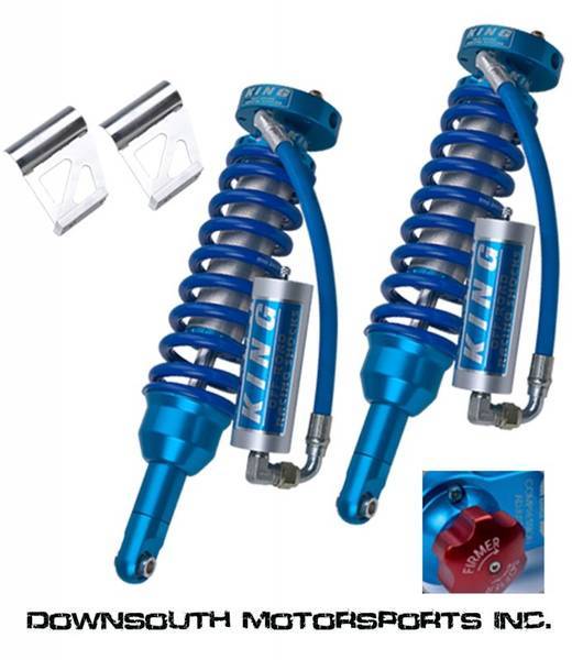

    I'm going with the King 2.5 RR CO with compression adjustment. King RR compression adjustment shocks in the back as well.
    What I don't know is what AAL or Leaf Pack and bump stop to go with. I'm between Wheelers and All Pro AAL's/leaf pack. Have no clue what bump stop works with this setup. I want to do the U-Bolt flip as well.
    I use my truck to haul a lot of heavy stuff - plywood, mortar, tile, landscape stuff, etc., etc. so I want an AAL that can accommodate hauling some weight BUT I don't want the unloaded suspension to be too stiff. I thought about Firestone bags but I'm not too crazy about that idea - wanna keep things simple. So I want to couple the Kings with a proper AAL/leaf pack and bumpstop. I like some decent rake in the back too.
    Any thoughts from those with experience with a similar setup?
