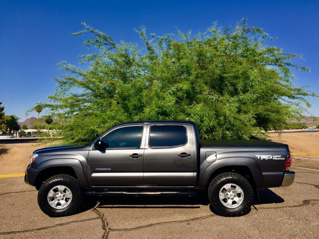

    So I went with the Bilstein 5100 shocks and struts on my 2014 TRD off-road. 2.5 in the front and the 1inch in the rear, it's a little nose high though. I also put on BFGoodrich AT KO2 265/75R16 with stock rims. Thanks to @Clearwater Bill for recommending @HeadStrong Off-Road

    Love the truck pretty much how I want mine to look... how is the ride up front with the shocks set at the highest setting is it a lot stiffer than stock?

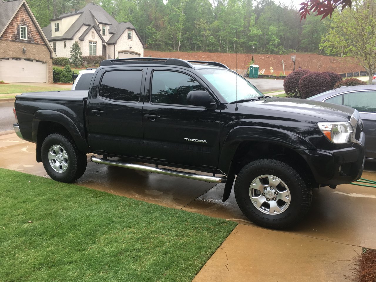

    That should work for you. Here is mine with just 5100s in the front at 1.75.
    Then my 3in kit

    What size tires for the top picture? Did you measure how much lift you got in the front from the 1.75? I imagine its not perfect.
