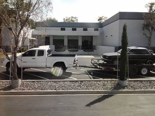

    This is my 09 AC with a wheelers progressive leaf pack and the overload leaf... no sag towing my 87 BMW. Also, have taken it on some decent wheeling at some dunes in TX and at cleghorn and they handle smoothly off road. They do feel a bit stiff on the road but I think it makes for much better handling... I have no complaints with the 5100 set up just my opinion
