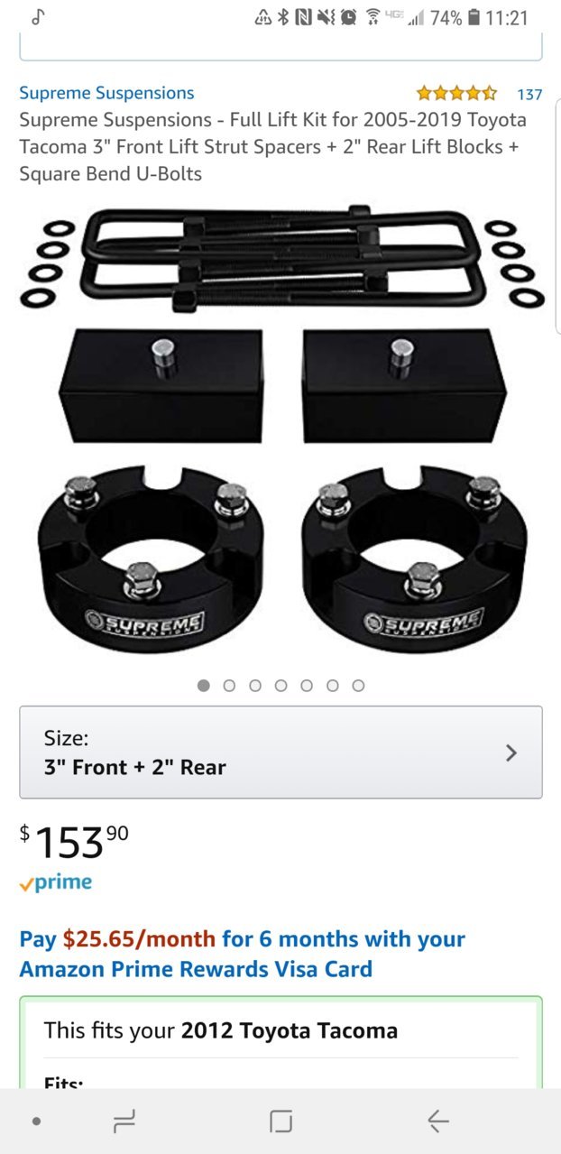

  2. Apr 20, 2019 at 8:05 PM
    tcjacado
    tcjacado Well-Known Member
    Aug 29, 2016
    #195947
    41,610
    Spacer lift is what you are looking for then

  4. Apr 20, 2019 at 8:23 PM
    Just Dandee
    Just Dandee Well-Known Member
    Mar 5, 2015
    #150227
    607
    Dan
    Southwest Idaho
    2015 TRD OR
    Supercharged-2.5 lift-255/85/16
    Spacer lift won’t stop you from going off road- you can see my link below but if it’s one or the other than go bigger on the tire-265/75/16 be done with it.

  5. Apr 20, 2019 at 8:24 PM
    tcjacado
    Aug 29, 2016
    #195947
    41,610
    That's the budget lift, next one up is bilstein 5100s and ome coils and a new leaf pack or aal to get the lift to clear the bigger tire. And you still will probably need to trim and cut, plus hammer the pinch weld. At a price tag of about 1500 to 2000 for lift/tires and chopping.

  14. Apr 21, 2019 at 11:22 AM
    crazysccrmd
    crazysccrmd Well-Known Member
    Mar 17, 2016
    #181592
    8,375
    Alaska
    Aprilia Tuareg 660
    255/85/16 or 255/80/17 will usually fit without rubbing on stock suspension. It will raise the height of the truck a bit over an inch compared to the stock size tires.
  15. Apr 21, 2019 at 11:22 AM
    CouchlessPotato
    CouchlessPotato Handcuffed to steering wheels still won firefights
    Jan 21, 2016
    #175655
    1,482
    Zach
    You don't buy a truck for its fucking fenders!
    2.5" lift w/35's
    I ran this on my truck for like 2 or 3 years with 33s and a cmc. No problems and I offroaded in places that this lift shouldn't have been lol
