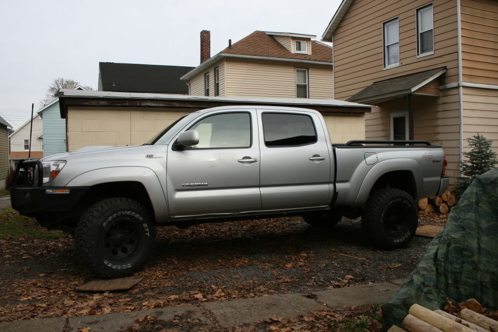

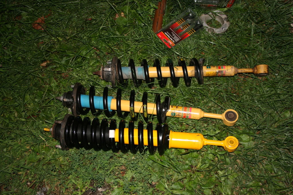

    Rich Beauregard
    Rich Beauregard Well-Known Member
    Sep 2, 2009
    #22179
    623
    Rich
    New London, CT
    17 Taco 4x4 SR5 Access Cab White
    Don't trust stock Bilstein junk shocks
    I went to www.trdparts4u.com and got the Old Man Emu suspension
    then put 1/2" toytec spacers on top, now I have 305/70/16 COOPER DISCOVERER STT's (33.7x12.1) on my American Eagle 185 Rims (Got all 4 for $485 NEW on ebay) Photo taken mid 2009
    #23

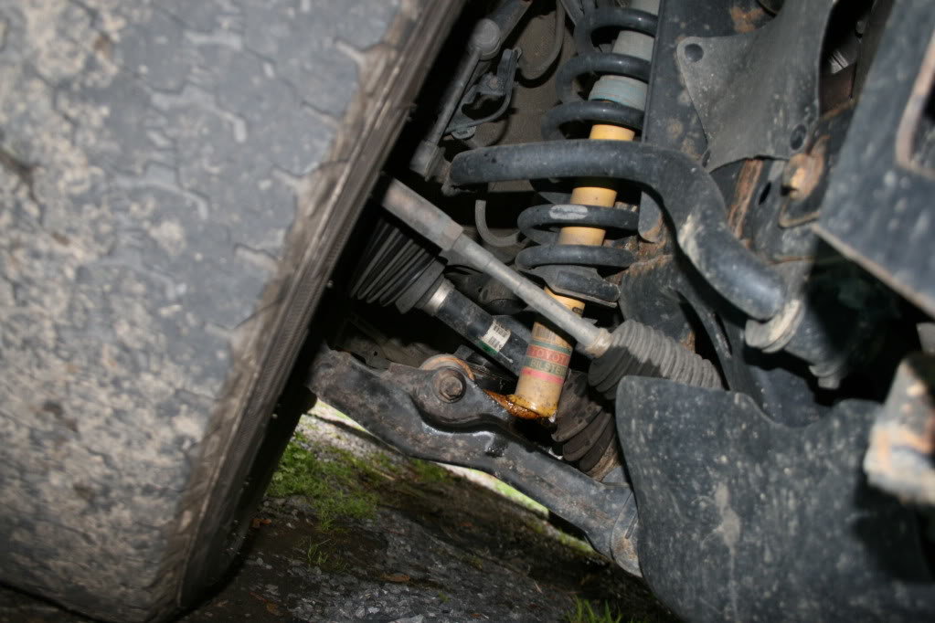

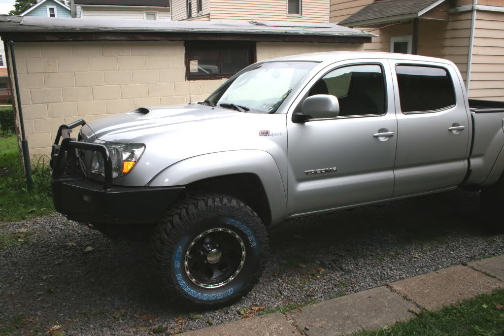

  4. Nov 25, 2010 at 5:05 PM
    #24
    Rich Beauregard
    Sep 2, 2009
    #22179
    623
    Rich
    New London, CT
    On the back I have OME / Dakar Leaf Springs with OME shocks. Photo taken 11-23-2010
