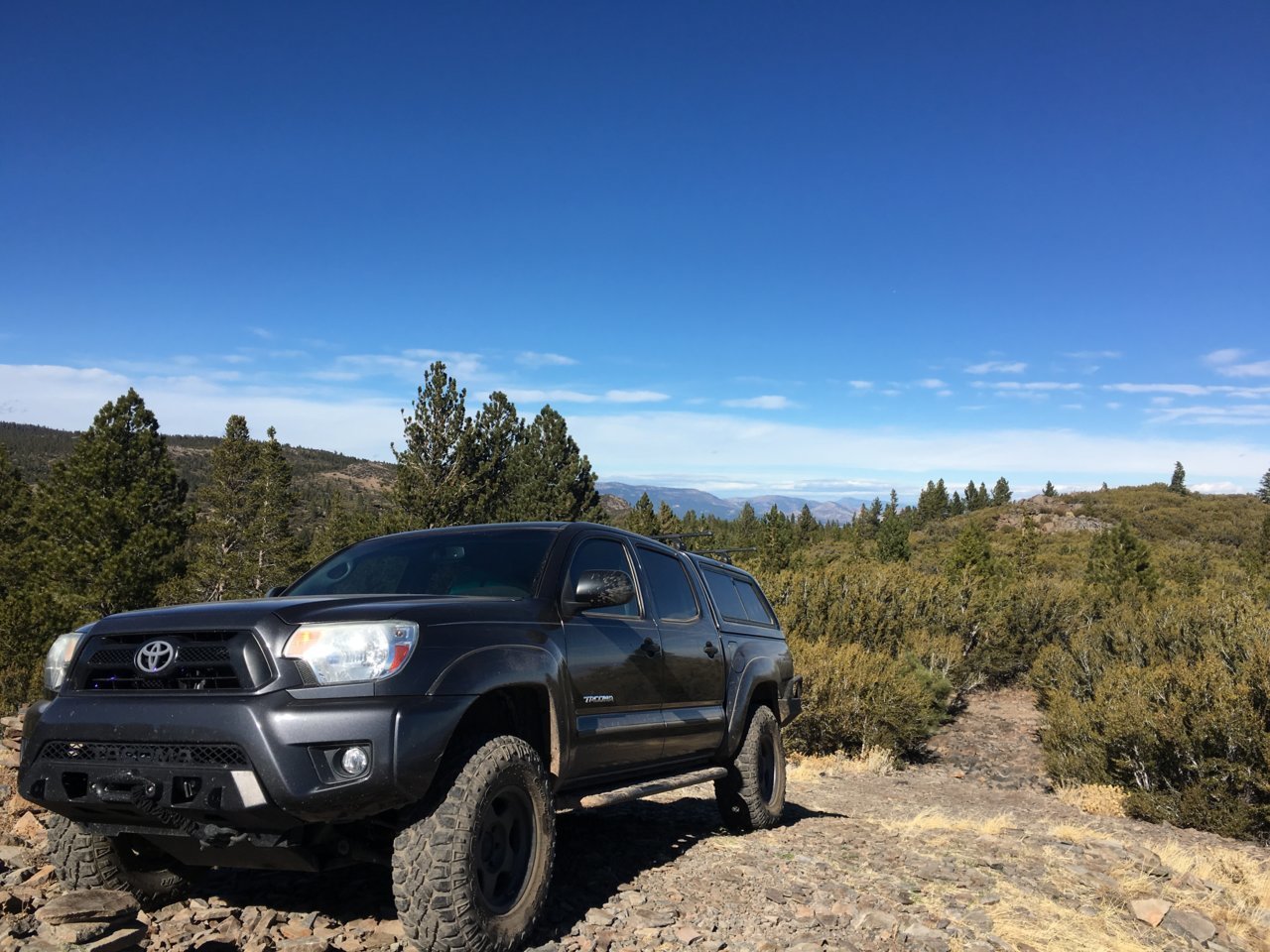

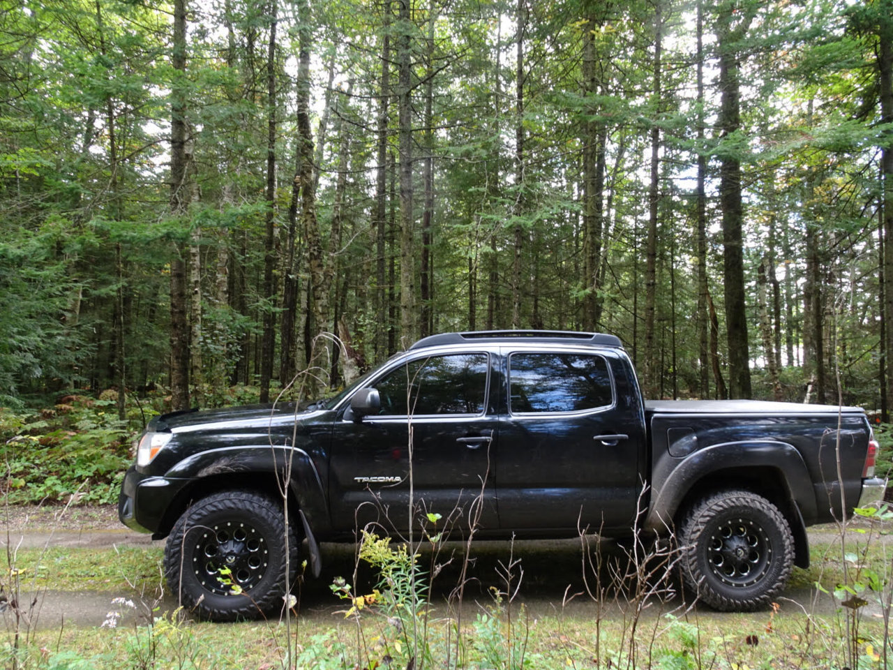

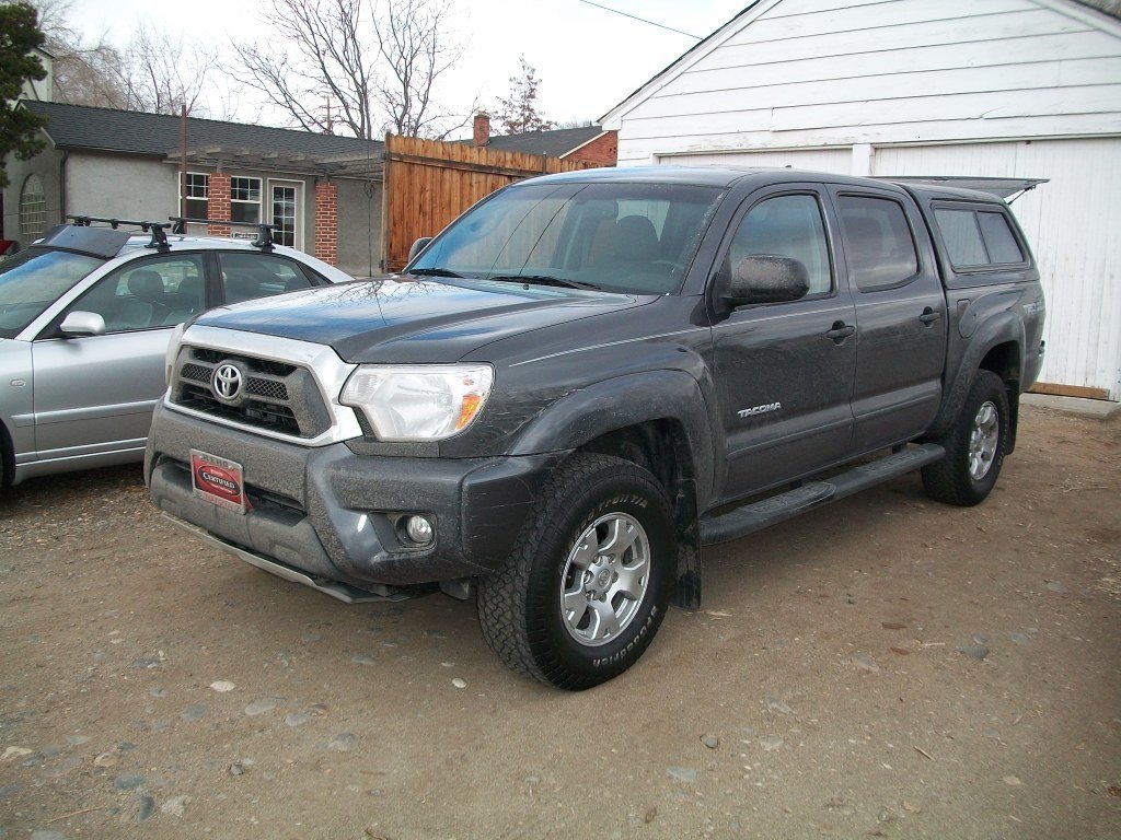

    @Lightyear68 here's my truck with stock wheels, tires, and suspension
    Stock wheels, 265/75/16 and about a 2" lift
    16x8 +0 wheels, 265/75/16, 2" lift
    16x8 +0 wheels, 285/75/16, 2" lift
    Rick's 2012 and Lightyear68[OP] like this.

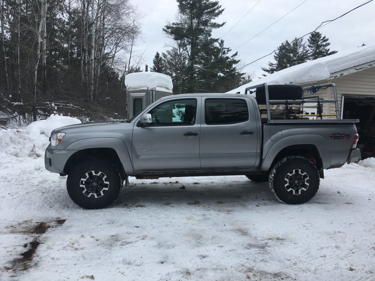

    Thanks for this photo. It shows me how my black 2014 Tacoma will look with black rims and better tires. I'm convinced that 265x75xR16 is the way for me to go.

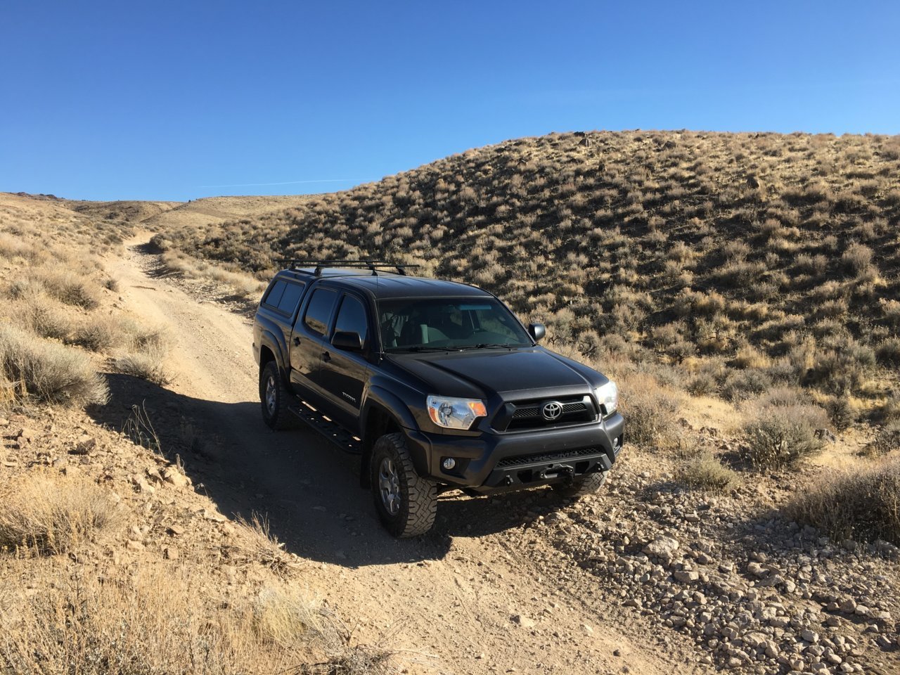

    Couple more for you
