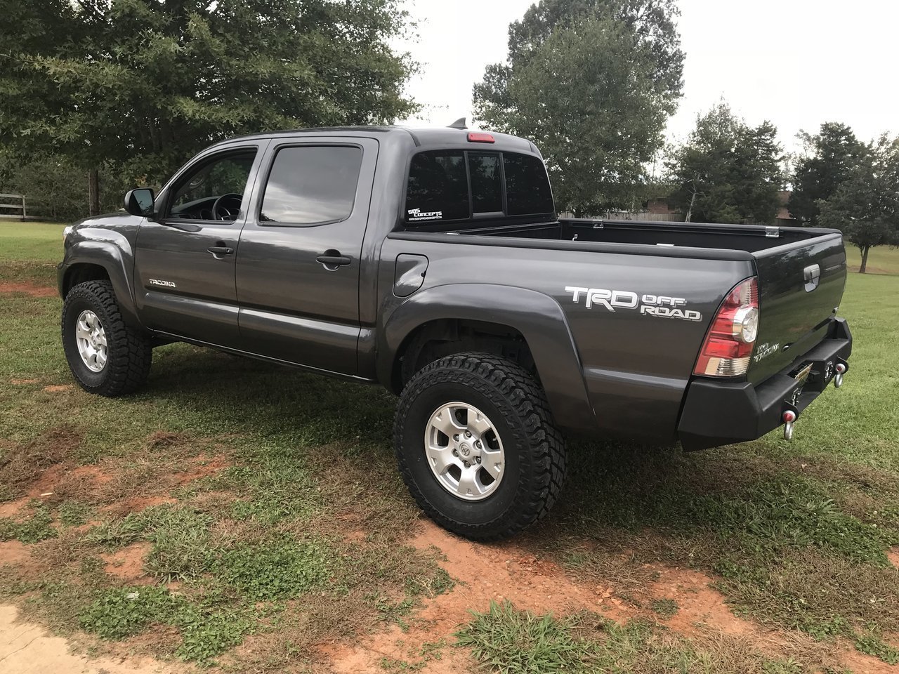

    '11 Tacoma CrewCab TRD off-road
    Bilstein 5100's at 0 with 885 springs. UCA's for alignment purposes only.
    -Yes i installed a taco lean spacer
    -I didn't need the carrier bearing drop. However i did install in an effort to get rid of an unknown vibration that ended up being a front wheel bearing.
    -no rear diff shim kit
    -Yes i am running the Icon AAL sits level
    -go with 285's you wont regret it.

    Thanks for the reply. Your truck look great, and really has the profile I'm going for.
    I now have a few additional questions though.
    I couldn't find the 5MM spacer on wheelers site. Does OME not have that as an option?
    Why the 5100's with OME 885? just because it is adjustable?
    1.5" AAL? Are AAL universal? I know I have a different set up from earlier 2nd gens. I think I have one less leaf and maybe they are mounted different (above or below axle)
    285's are ideally what I want, however due to budget concerns I cannot afford new offset wheels. I also do not wish to do the chop mods. Mud flaps I could deal with, but not the cab. Also, I cannot afford to do the UCA's at this time either. It was my impression that for 285's that I needed a full 3" lift, and also a 4.5 backspacing on wheels or a wheel spacer.
    For the 285's with OME would I have to use the 5MM spacer and the 1/2" lift enhancers to make them fit?
    Sorry for all the questions, but I feel like i am biting off more than I can chew, and want to make sure I gain as much knowledge as I can before purchasing.

    this is the taco lean plate i bought for my drivers side.
    -I went with the 885's and 5100's because my buddy who influenced me to buy a tacoma probably put near 10,000 dirt miles on this exact setup. His truck rode and looked great so i stuck with what i knew. Didn't wanna try to be different and regret it.
    -Yea mines a 1.5" AAL from Icon. not 100% familiar with all the different tacoma setups, but its the only Icon AAL pack I could find for our trucks.
    -My wheels have a 4.5 backspace, I didn't have to cut the cab mount(I have UCA's with 3 degrees of castor though), but i did end up chopping a shit load of plastic off the inner fender. With the 265's you shouldn't have to trim or cut anything
