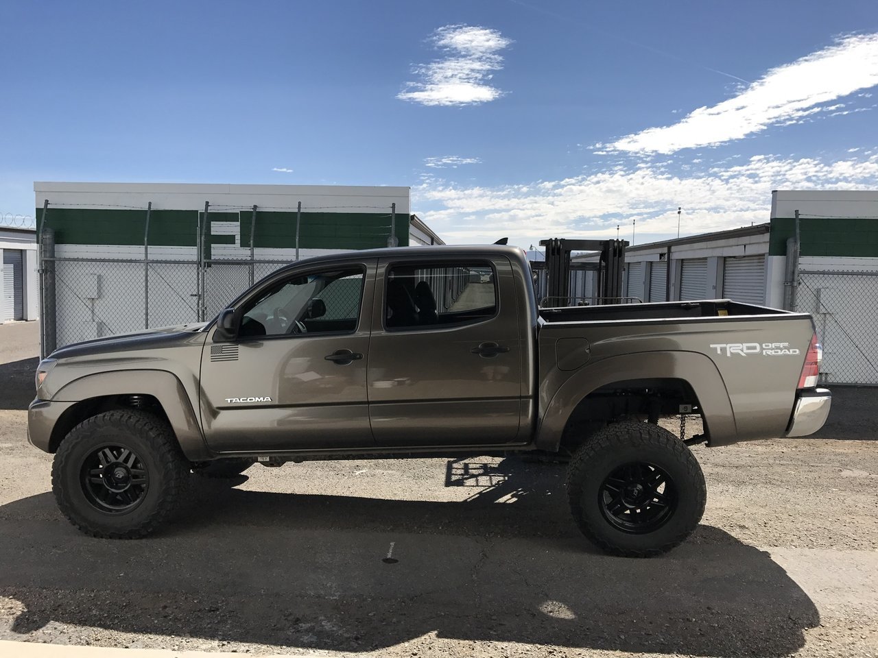

    Reno
    2014 TRDOR pyrite mica, 3" lift 33's, 4.56’s
    Yes I still have the swaybar connected
    Yep exactly!
    Matmo215[QUOTED] likes this.
  7. Feb 1, 2018 at 7:03 PM
    #47
    Matmo215
    Matmo215 Well-Known Member
    Sep 15, 2016
    #197333
    7,646
    Matthew
    Waco, TX
    2015 Sport DCSB
    Thought so, I have the 16" stealth 6's and I'm dreading the amount of stuff ill have to chop with 285's
  8. Feb 1, 2018 at 7:06 PM
    #48
    Paul123
    Paul123 Web-Wheeler
    Feb 26, 2016
    #179510
    822
    Paul
    Reno
    Yeah I’m sure you’ll have to do the cab mount chop and some inner fender work.
