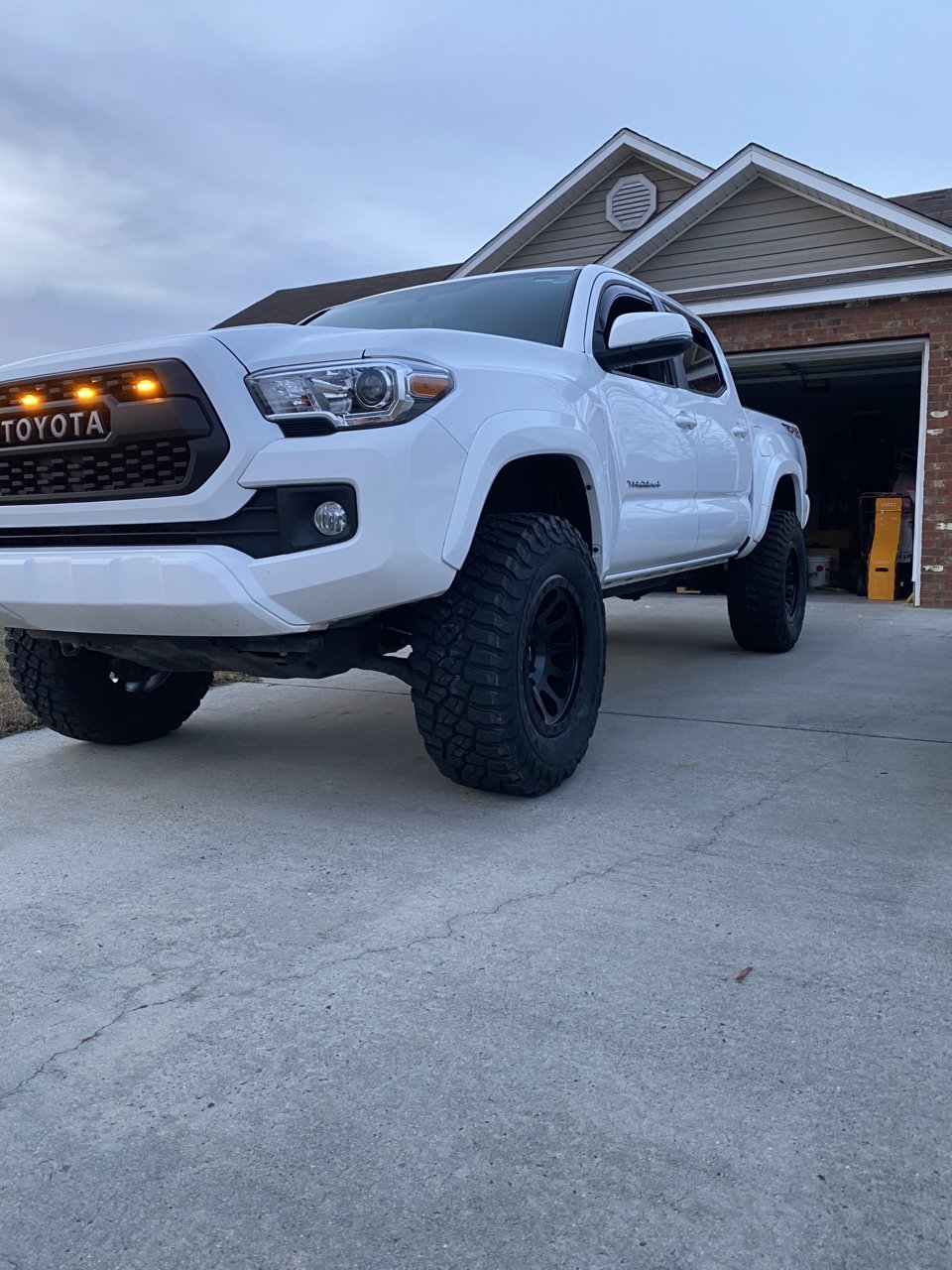

    3 Inch Suspension lift Fuel Offroad Vector 17x9 BFG KM3 285/70/17
    I have 285s with a -12 offset wheel and have to rubbing anywhere.

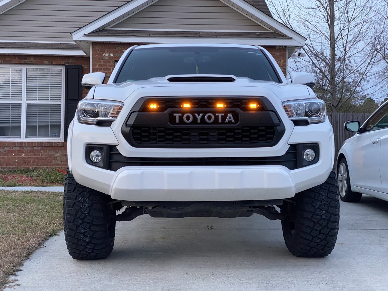

    Do you have a pic of your truck from the front with this configuration?
  14. Feb 15, 2020 at 6:21 PM
    T_Luke14
    T_Luke14 New Member
    Feb 15, 2020
    #319343
    4
    White 2017 Tacoma TRD Sport 4x4
    This is from the front, forgot to mention I also have 3 inches of lift

    I think that's a great look. I don't know much about wheel offset, I'm still learning. Did you accomplish that with wheel spacers?

    Wheel offset is listed when your purchase you wheels. Negative offset brings the wheel further out towards the toad. Positive offset bring the wheel in closer to the engine bay. Negative offset allows for bigger tires with less chance of rubbing! At least that’s what I was told. Anyone with better info can correct me if I’m wrong!
