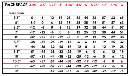

    so questions needing answers.>>> if i get rims, what offset do you think?? do i need rims or can i just do spacers?
    >>> what lift should i do? just new shocks? if so by who and which ones>>> need to be very durable, like high impact durable.

    If you don't plan on going larger then 11.50 wide then you can just run spacers w/ the stock wheels...if you are getting wheels...I suggest 4" or smaller backspacing to clear the UCA's. Remember...the smaller the BS on the wheels...they more they stick out.
