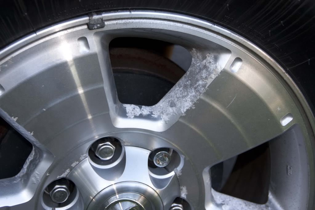

    Yeah this is true but my stock alloys where a mess, see below as an example. Plus I enjoy doing minor work on my truck, I haven't had it long but it has become a hobby of mine. Plus it is nice having a vehicle that is cheap to mod, I had BMW before and replacing my shift boot and e-brake boot was more expensive than the rims I bought for my tacoma.

    My alloys were exactly the same , the dealer replaced them with a week left in my warranty .

    Yeah I bought my truck used, it is CPO'd though, if I wanted stock wheels I would have pushed for the dealer to replace them but I knew I would go after market. Plus I sold and old set of wheels I had from my previous car that payed for my new wheels so it was kind of a wash, so to speak.
    Either way I am very happy with my setup now, will be even happier once I get my front shocks installed. Also, I may attempt to refinish the old stock wheels, will be another little project for myself to tackle, will have to wait until this spring to do it though.
