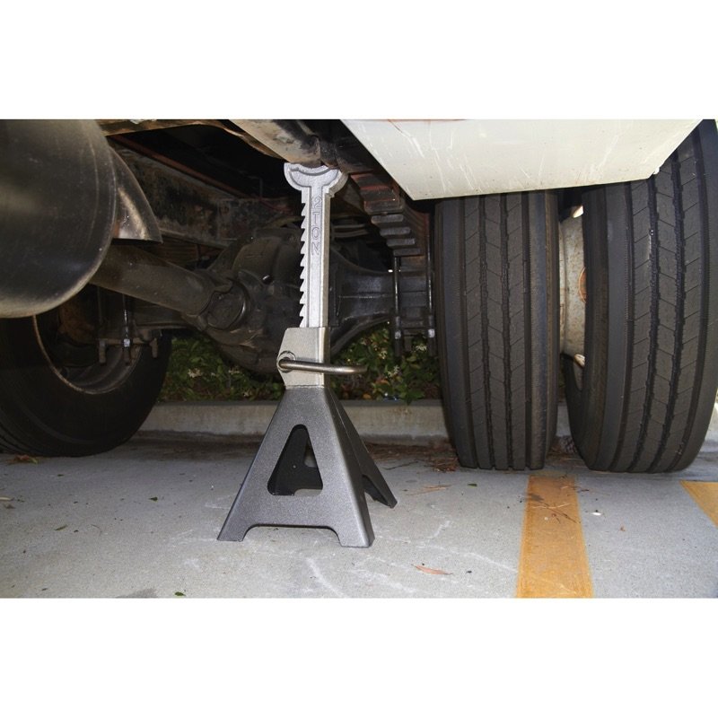

    I wager more lifts are installed in driveways than by shops.
    You need a floor jack and jack stands tall enough to support the truck with its tires off the ground but not on suspension components. In front that's not a problem but in the rear it means you need stands tall enough to touch the frame and let the rear springs droop.
    I have a set of 12 ton stands for this like above. Not so much for the capacity but that they top out at 20". I got them at Harbor Freight during a sale. Alternatively you can build cribbing using wood (NEVER cinder or cement blocks) to get your stands to reach. With 6 ton stands you use a couple of 4x4s to gain some height.
    In any case, front or rear, once you raise the truck and remove the wheels you gain clearance, a foot or more easily. So if you got out and measure your frame height off the deck right now it'll seem like you need 30" tall stands, which isn't the case.

    A good jack, jackstands (6 ton are best to get the height you need) and basic hand tools are all you need to get the job done in a few hours. There are tons of YouTube videos to help you out. It is not hard.

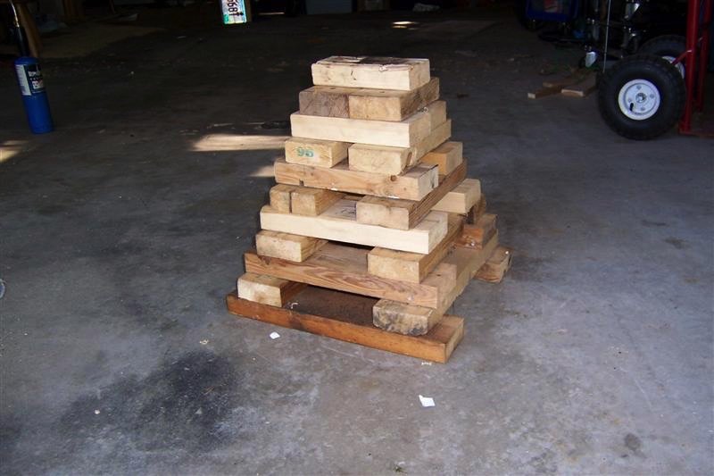

    Bro that’s a jenga tower
