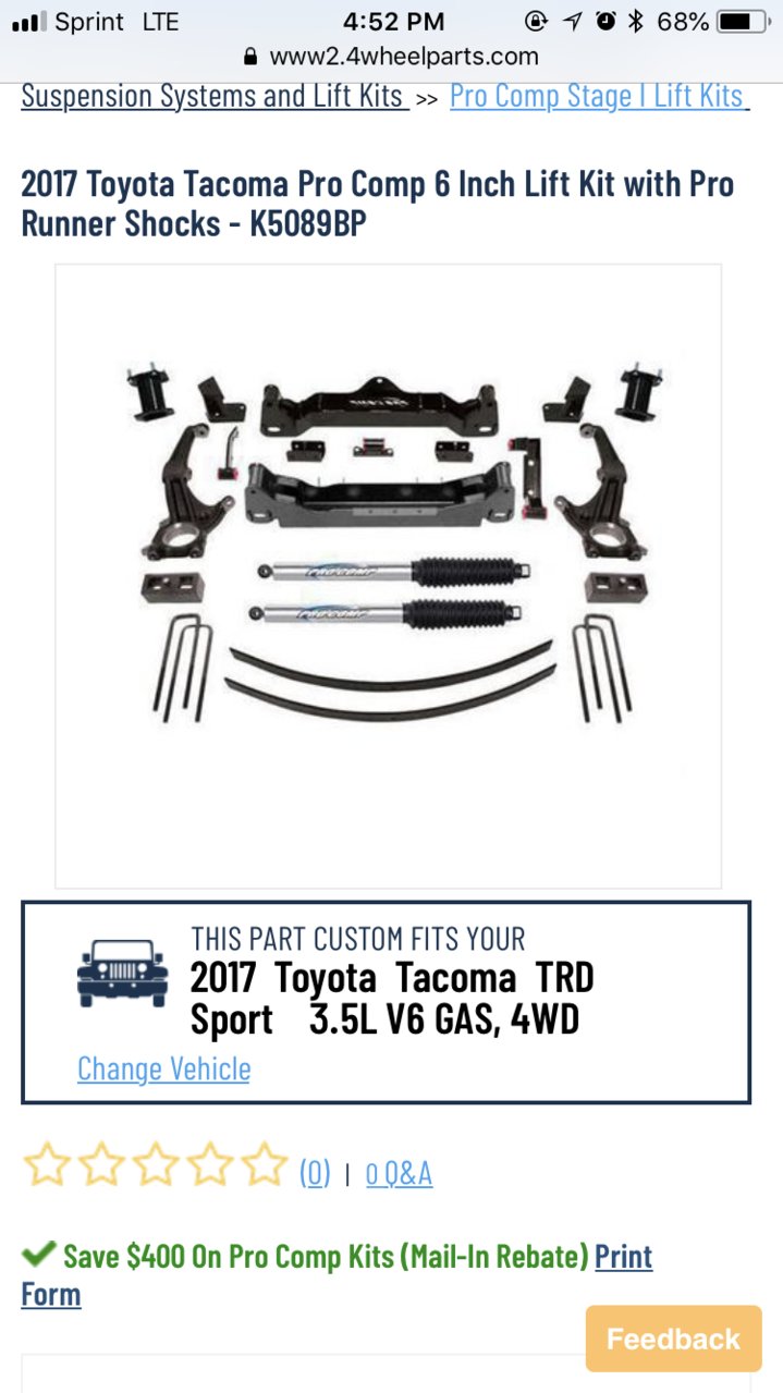

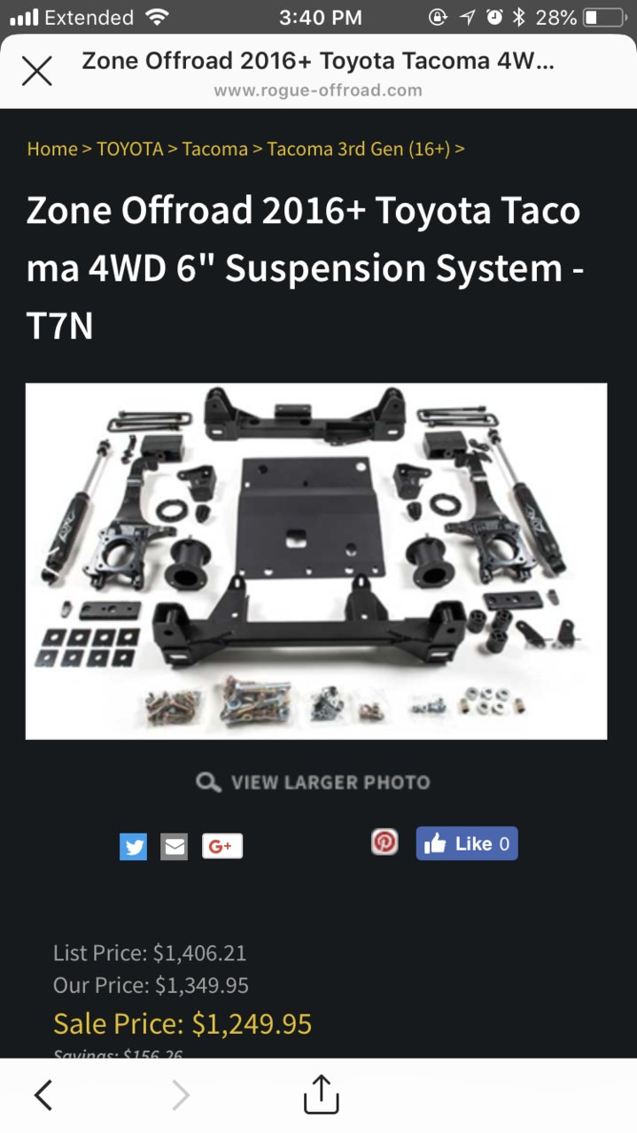

    I was thinking about between these lift. What’s the pros and cons

  16. Sep 8, 2018 at 6:50 PM
    #16
    Alohajerry
    Alohajerry [OP] Active Member
    Feb 21, 2018
    #245159
    25
    Jerry
    Oahu
    2017 toyota tacoma trd sport 4x4
    Which lift ? And what is a 3”
  17. Sep 9, 2018 at 1:37 AM
    #17
    PK808
    PK808 Well-Known Member
    May 9, 2015
    #154941
    143
    Payton
    Hawaii
    2009 Tacoma MGM SR5 4x4 S/C (SOLD in 2020), 2020 T4R NB Venture 4x4
    They both look like kits that utilize a strut spacer to obtain the 6 inches up front. If you want to retain a decent ride, would suggest one of these kits with a longer coil over assembly instead. You may grow tired of how it rides with a strut spacer setup.
